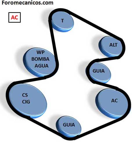

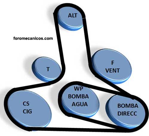

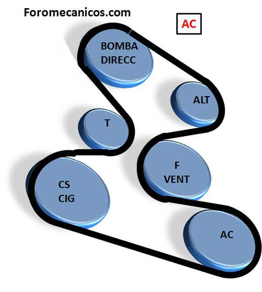

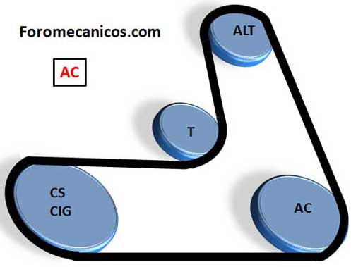

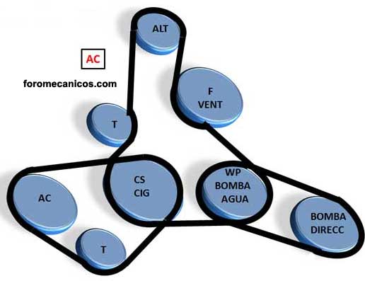

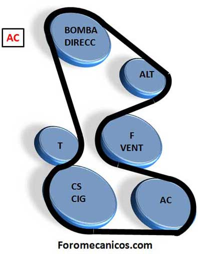

90/100/CABRIOLET 1991-98 -NO A/C 90/100/CABRIOLET 1991-98 -  AGOST 91 A/C 90/100/CABRIOLET 1991-98 -   AGOST 91-JUL 94 A/C 90/100/CABRIOLET 1991-98 - A/C 200/S4 2.2 1988-94 - NO A/C 200/S4 2.2 1988-94  A/C A3 2.0  2005 A/C
A3 3.2  2006  A/C A4 1996-00 A4 1996-00 A/C A4 2001 A4 2001  A/C A4 / CABRIOLET 2002 A4 / A6 1996-06
A4 / A6   2.8 /3.0 1996-06 A4/S4  2.7-2.8  1997-2002 A4/S4  2.7-2.8  1997-2002  A/C A6/ALLROAD 2.7/2.8  1995-05 A6/ALLROAD 2.7/2.8  1995-05  A/C A6/A8 3.7 / 4.2  1997-06 A/C A6/ALLROAD S/4 4.2 2003-06
A8  6.0 2004 RS6/S6/S8  4.2 2001-04 A/C S6 2.2 1995 A/C TT 1.8 1999-06 TT 1.8 1999-06 A/C TT 3.2 2004-06

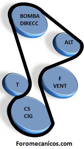

AP= Air Pump  Bomba de Aire
CS= Crankshaft  Ciguenial
F= Fan Ventilador
G= Guide Guia
GEN = Alternator Alternador
T= Tensioner Tensor
WP = Water pump Bomba de Agua
