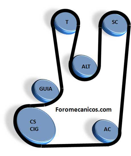

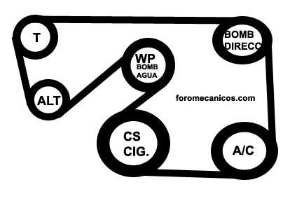

ION 2.0L  2005... ION / SERIE L / VUE 2.2L  2.4L 2000... L300 2001-05 RELAY 3.5L 2005.. RELAY 3.9L 2006... PAS

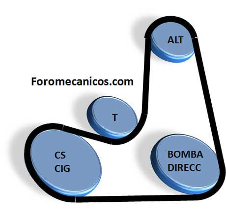

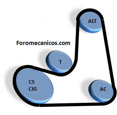

RELAY 3.9L 2006... SERIES S / SERIES S COUPE  1995/2002 SERIES S / SERIES S COUPE  1995/2002  PAS SERIES S / SERIES S COUPE  1995/2002  A/C SERIES S / SERIES S COUPE  1995/2002  PAS - A/C

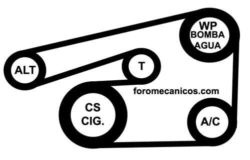

VUE 3.0L  2002-03  A/C VUE 3.5L 2004.. PAS
AP= Air Pump  Bomba de Aire
CS= Crankshaft  Ciguenial
F= Fan Ventilador
G= Guide Guia
GEN = Alternator Alternador
T= Tensioner Tensor
WP = Water pump Bomba de Agua
