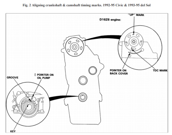

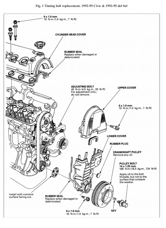

7.On all models, remove the crankshaft pulley, then remove the timing belt upper and lower covers, Fig. 1.

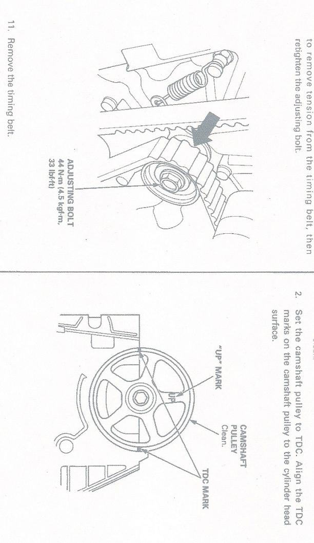

8.Loosen the timing belt tensioner adjuster bolt by 1/2 turn. Rotate the timing belt tensioner until tension is released from the timing belt. Temporarily tighten the timing belt tensioner in this position.
9.Ensure the No. 1 piston is at TDC on the compression stroke and the camshaft sprocket is aligned, Fig. 2.
10.Remove the timing belt.

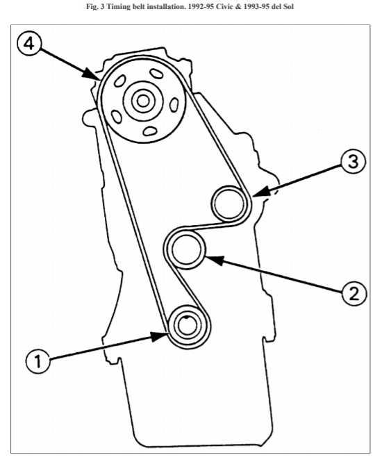

11.Install the new timing belt in sequence, Fig. 3, then loosen the timing belt tensioner adjusting bolt by 1/2 turn. The tensioner will rotate, applying tension to the timing belt. Tighten the tensioner adjusting bolt.
12.Rotate the crankshaft 4-6 turns counterclockwise to seat the timing belt on the sprockets.
13.Adjust the timing belt tension as follows:
a.Temporarily install the crankshaft pulley and bolt. Torque the pulley bolt to 134 ft. lbs.
b.Rotate the crankshaft counterclockwise 3 teeth to create tension on the timing belt. Ensure the timing belt and the camshaft sprocket are securely engaged, then torque the timing belt tensioner adjustment bolt to 33 ft. lbs.
c.Ensure the crankshaft and camshaft sprockets are at TDC.
14.Remove the crankshaft pulley, then install the timing belt upper and lower covers. Torque the cover bolts to 84 inch lbs.
15.Install the crankshaft pulley and bolt. Torque the pulley bolt to 134 ft. lbs.
16.Install the cylinder head cover. Torque the nuts to 84 inch lbs.
17.Install the engine support bolt and nuts. Torque the bolts and nuts to 38 ft. lbs. Torque the through bolt to 54 ft. lbs.
