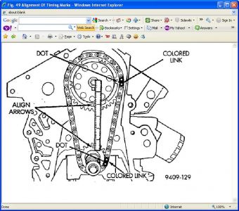

hola a todos, soy nuevo en el foro, podria alguien apoyarme con el diagrama de la cadena de distribucion de un motor 3.3 caravan,

TIMING CHAIN INSTALLATION
Position a new crankshaft sprocket on the shaft, install sprocket with suitable tool and mallet. Be sure sprocket is seated into position.
Rotate crankshaft so the timing arrow is to the 12 o'clock position.
Place timing chain around camshaft sprocket and place the timing mark to the 6 o'clock position.
Align the dark colored links with the dot on the camshaft sprocket, place timing chain around crankshaft sprocket with the dark colored link lined up with the dot on the sprocket and install camshaft sprocket into position.
Fig. 49 Alignment Of Timing Marks
Using straight edge to check alignment of timing marks Fig. 49 .
Install camshaft bolt and washer. Tighten to 54 Nm (40 ft. lbs.) .
Rotate crankshaft 2 revolutions. Timing marks should line up. If timing marks do not line up remove cam sprocket and realign.
