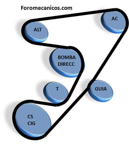

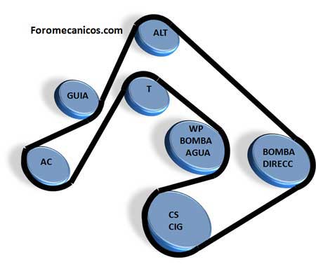

CAMARO / CAPRICE / IMPALA / SS, 5.7L 1993-97 IMPALA / SS,CAPRICE / CAMARO / 5.7L 1993-97 CAPRICE / CAMARO / IMPALA / SS, 5.7L 1993-97 |

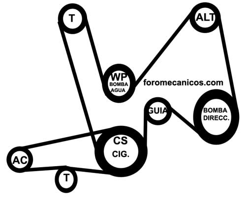

CAMARO /BERETTA / CORSICA / IMPALA 3.1 / 3.4 1993-00.. A/C IMPALA 3.1 / CORSICA / BERETTA / CAMARO / 3.4 1993-00.. A/C |
