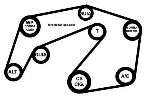

M-CLASS [164] 5.5L ML550 273.963 2008/10------ GL [164] 5.5L GL550 2008/10 273-963---- E-CLASS [211] 5.5L E550 273.960 2007/09--- SL-CLASS [230] 5.5L SL550 273.965 2007/10 |
GL [164] 5.5L GL550 2008/10 273-963 A/C----- M-CLASS [164] 5.5L ML550 273.963 2008/10 A/C----- SL-CLASS [230] 5.5L SL550 273.965 2007/10 A/C----- E-CLASS [211] 5.5L E550 273.960 2007/09 A/C |

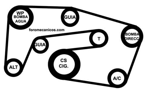

S-CLASS [221] 6.0L S65 AMG 2007/10 275-982----- S-CLASS [221] 5.5L S600 2007/10 275-953----- SL [230] 5.5L SL600 2007/10 275-954 |
