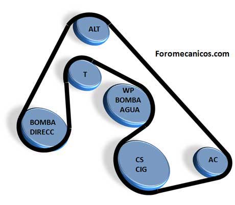

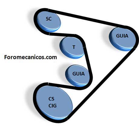

NINETY EIGHT 3.8LSC L67 1994-96/ EIGHTY EIGHT 3.8L SC L67 1995/ LSS 3.8L SC L67 1996-98/ LSS 3.8L L36 1996-98 |

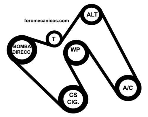

EIGHTY EIGHT 3.8L L27 1991-94/ NINETY EIGHT 3.8L L27 1991-94 |
