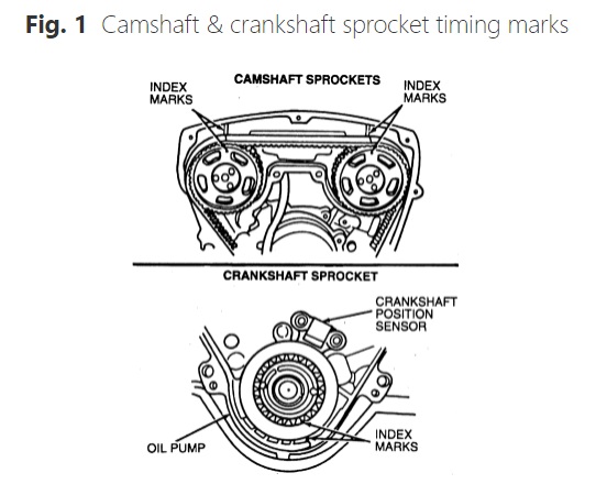

Que tal amigo, serian tan amables de orientarme en el procedimiento para poder ajustar el tiempo de un taurus 1994 3.0 SHO, 12 valvulas.

hola, primero localiza el SPOUT, ese es como un fusible de esos de plástico, pero color gris, esta junto al distribuidor, prendes el motor y desconectas o sea, quitas el spout, y lo pones a 10 grados antes del pms y listo, alguna duda??

14.Place the transaxle in Neutral, then rotate crankshaft in the clockwise direction and position the number 1 cylinder at TDC compression stroke. Ensure the crankshaft damper white mark is aligned with the "0" mark on the lower timing belt cover and the camshaft sprockets are aligned with the marks on the inner timing belt cover, Fig. 1.

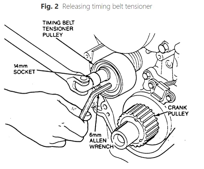

18.Loosen the timing belt tensioner pulley lock nut, then using a 6 mm hex wrench, rotate the pulley 180° to release timing belt tension, Fig. 2. After releasing the timing belt tension, tighten the lock nut to hold the tensioner pulley in the released position.

20.Ensure the camshaft sprocket timing marks are aligned with the mark on the timing belt inner cover, Fig. 1. Also ensure the crankshaft sprocket timing mark is aligned with the oil pump cover mark.
21.Install the new timing belt. When installing the belt, position the three yellow lines on the belt to the index marks on the crankshaft and camshaft sprockets. Ensure the lettering on the belt faces toward the rear of the engine.
