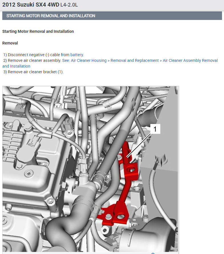

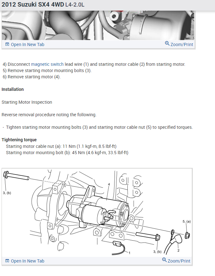

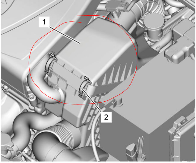

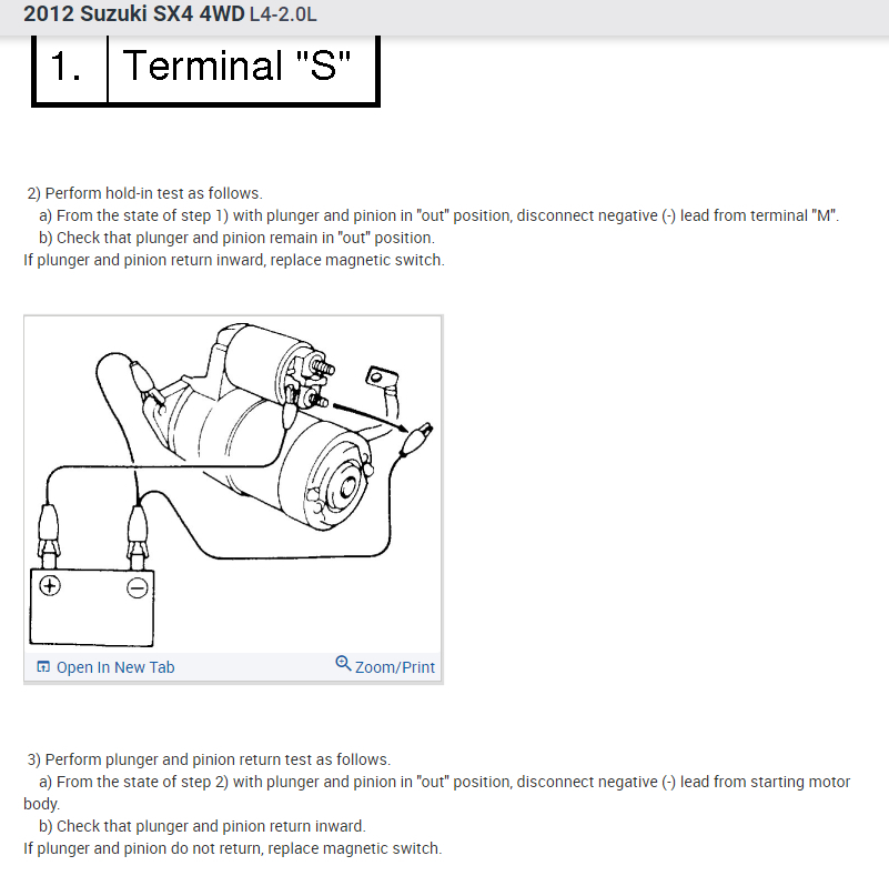

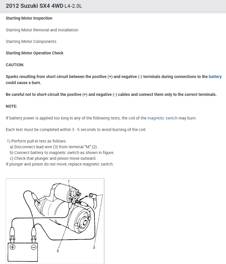

Amigos, les comparto este manual para cambiar el arrancador en una suzuki SX4 2.0L 4cil
starting motor removal and installation

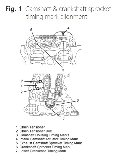

Y para reemplazar la cadena de tiempo para suzuki SX4 2.0L 4cil 2007/ 2013
TIMING CHAIN, REPLACE
REMOVAL
1.Remove front timing chain cover.
2.Turn crankshaft clockwise and align timing marks on CMP actuator and exhaust camshaft timing sprocket with match marks on camshaft housing No. 1, Fig. 1.
3.Align timing mark on crankshaft timing sprocket with match mark on lower crank case, Fig. 1.
4.Remove timing chain tensioner adjuster, then tensioner.
5.Remove timing chain guide and timing chain.
INSTALLATION
1.Align timing mark on CMP actuator and exhaust camshaft timing sprocket with match marks on camshaft housing, Fig. 1.
2.Align timing mark on crankshaft timing sprocket with match mark on lower crank case, Fig. 1.

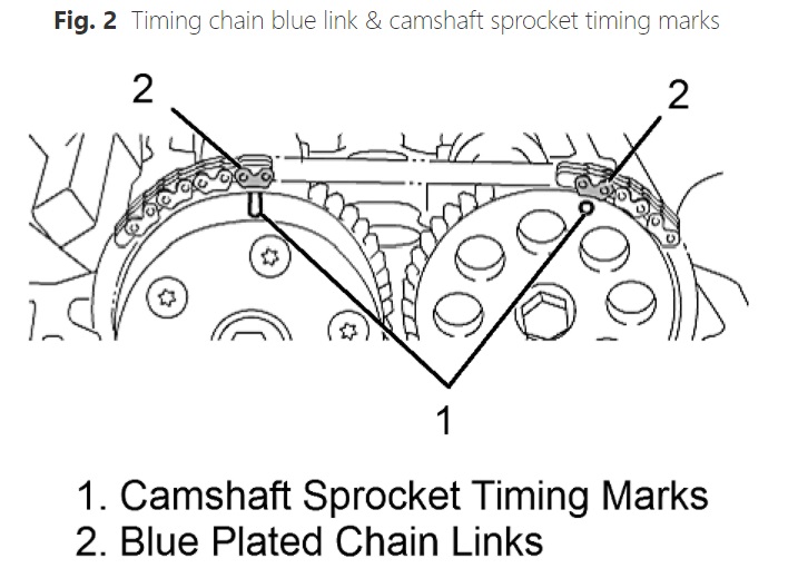

3.Install timing chain aligning two blue plates with timing marks on CMP actuator and exhaust camshaft timing sprockets, Fig. 2.
4.Align blue plate on timing chain with timing mark on crankshaft timing sprocket.

8.Ensure all timing marks are aligned, Fig. 1.

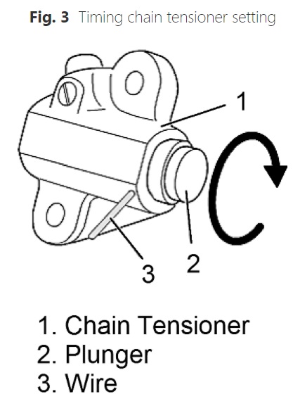

9.Screw in plunger of tensioner adjuster clockwise, then install a suitable piece of wire to hold plunger in place, Fig. 3.
10.Install timing chain tensioner adjuster, then remove retainer. Torque timing chain tensioner adjuster bolt to 102 inch lbs.
11.Apply clean engine oil to timing chain, then turn crankshaft clockwise two complete revolutions and ensure timing marks on CMP actuator and exhaust camshaft timing sprocket are aligned with match marks camshaft housing No. 1.
12.Ensure timing mark on crankshaft timing sprocket is aligned with match mark on lower crank case, Fig. 1.
