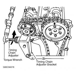

3. Loosen 3 bolts 1/2 turn on each sprocket of cylinder head camshafts. Temporarily install upper right side timing chain cover. Install Timing Chain Bracket (11-2-400) to side of right cylinder head. See Fig. 10 . Install Timing Chain Adjuster (1-3-390) enough to remove slack from timing chain. See Fig. 10 . Remove TDC Position Pin (11-2-300). Turn engine one complete revolution.

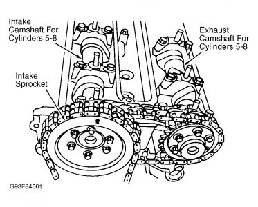

4. With engine at TDC of No. 1 cylinder, install TDC Position Pin (11-2-300). Loosen remaining bolts 1/2 turn on each sprocket of cylinder head camshafts. Ensure cylinder No. 1 intake and exhaust cam lobes face each other. See Fig. 3 . Ensure cylinder No. 5 intake and exhaust cam lobes face correctly. See Fig. 4

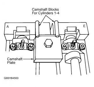

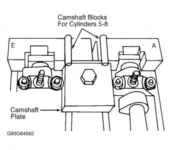

5. Ensure arrows on intake camshaft sprockets point up. See Fig. 3 and Fig. 4 . Install Camshaft Alignment Blocks (11-2-441 and 11-2-442) and Mounting Plates (11-2-443 and 11-2-444) to rear of each cylinder head. See Fig. 5 and Fig. 6 .

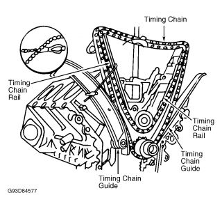

6. Remove Timing Chain Adjuster (1-3-390). Remove timing chain cover. Remove bolts and sprockets from intake camshaft. Tie lower timing chain to chain rails and guides. See Fig. 11 .
7. Remove vibration damper and lower timing case cover. See CRANKSHAFT FRONT SEAL . Remove timing chain tensioner guide from right side. Remove timing chain. Remove timing chain oiler. Remove bolts and remaining chain guide and rails.

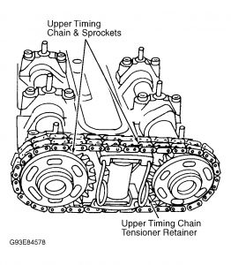

8. Remove timing chain idler sprocket (above crankshaft timing sprocket). If necessary, install Tensioner Retainer (11-3-420) to upper timing chain tensioner. See Fig. 12 . Remove upper timing chains and sprockets from camshafts. Using Gear Pullers (11-2-004 and 11-2-000) and support washer, pull crankshaft timing chain sprocket off of crankshaft.

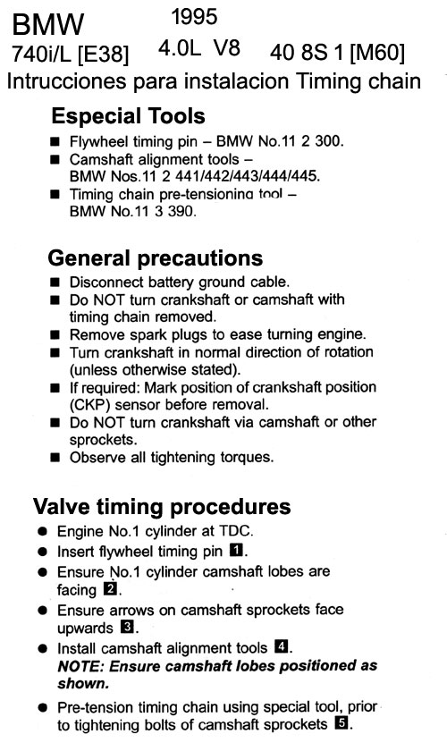

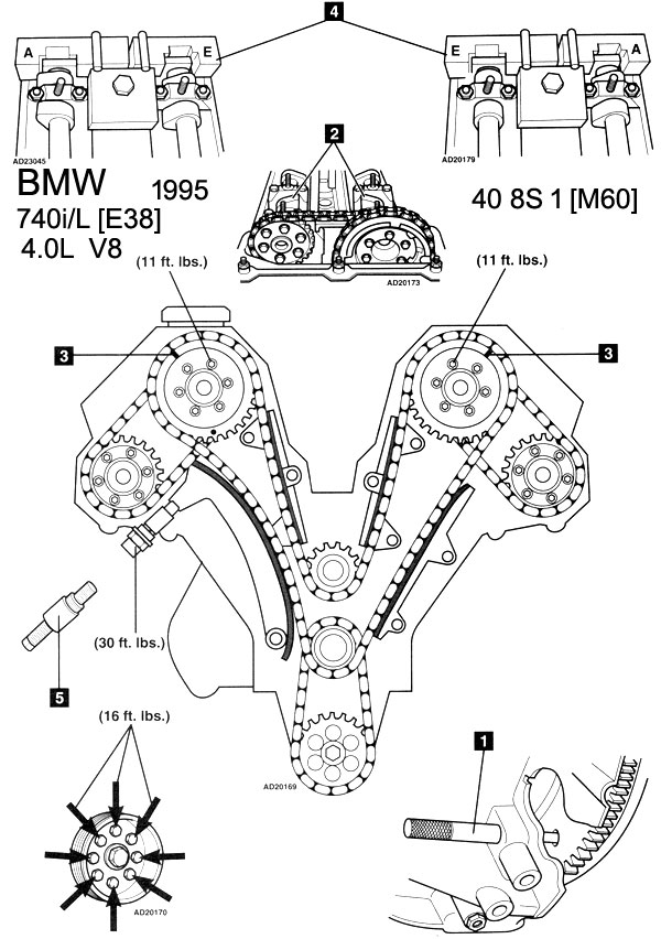

Gracias Damian!, estos diagrama de cadena de tiempo tambien sirven para
BMW 1995 - 740i /L E38 4.0L V8 y
BMW 1995 - 40 8S 1 M60
