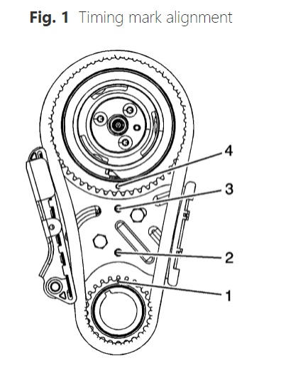

17.Align timing marks, Fig. 1.

d.Align timing marks, Fig. 1.
e.Hold camshaft gear with chain hanging down and install chain to crankshaft gear.
f.Align camshaft gear timing marks and dowel with camshaft gear dowel hole.
