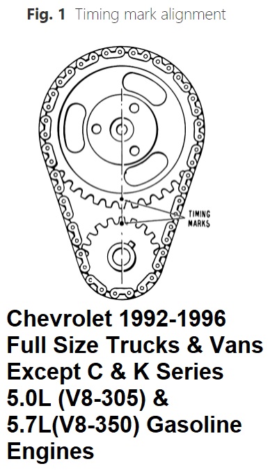

Poniendo a tiempo un Cheyenne 1996 5.7L , comparto diagrama con las marcas

Hola, comparto instrucciones para cambio de cadena de tiempo en
1992-1996 Full Size Trucks & Vans Except C & K Series 5.0L (V8-305) & 5.7L(V8-350) Gasoline Engines
TIMING CHAIN & GEAR SET, REPLACE
1.Remove timing case cover as outlined previously.
2.Remove crankshaft oil slinger.

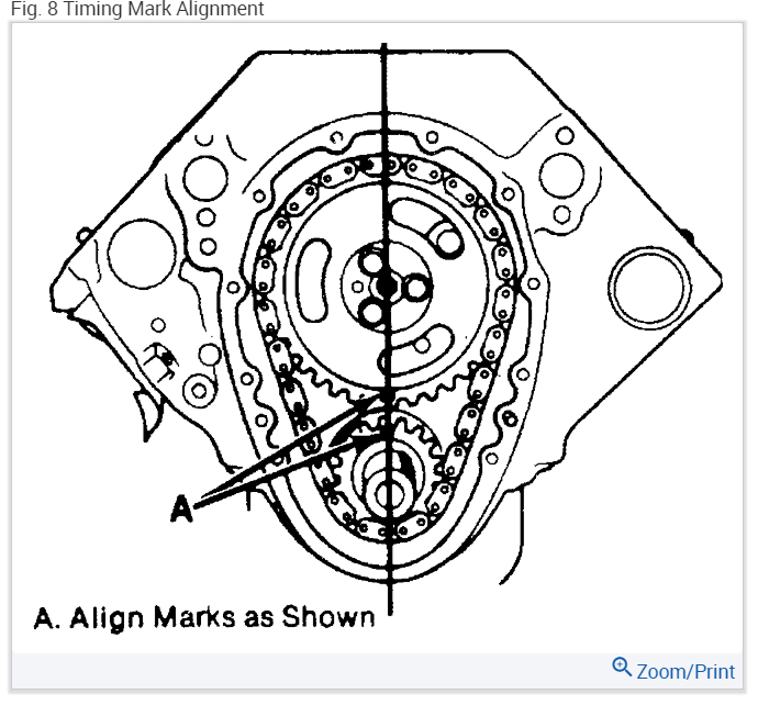

3.Position timing marks on sprockets as shown in Fig. 1.
4.Remove three camshaft to sprocket bolts.
5.Remove camshaft sprocket and timing chain together. Sprocket is a light press fit on camshaft for approximately 1/8 inch. If sprocket does not come off easily, a light blow with a plastic hammer on the lower edge of the sprocket should dislodge it.
6.If crankshaft sprocket is to be replaced, remove it with a suitable gear puller. Install new sprocket, aligning key and keyway.
7.Install chain onto camshaft sprocket. Hold sprocket with chain hanging vertically, then align marks on sprockets as shown, Fig. 1. The valve timing marks shown do not indicate TDC compression stroke for No. 1 cylinder, which is used during distributor installation. If distributor was removed, install timing chain and sprockets, aligning timing marks, Fig. 1, then rotate engine until No. 1 cylinder is on compression and crankshaft timing mark is 180° from valve timing position. Install distributor.
8.Align dowel in camshaft with dowel hole in sprocket and install sprocket on camshaft. Do not attempt to drive sprocket on camshaft as welch plug at rear of engine can be dislodged.
9.Draw sprocket onto camshaft, using the three mounting bolts. Tighten to specification.
10.Lubricate timing chain and install cover.
