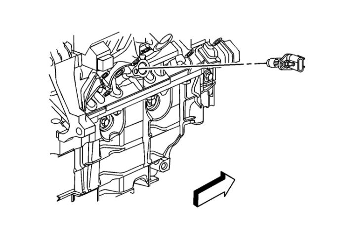

1. Raise and support the vehicle. Refer to Vehicle Lifting.
2. Disconnect the crankshaft position (CKP) sensor electrical connector (4).
3. Remove the CKP sensor stud.
4. Remove the CKP sensor.
