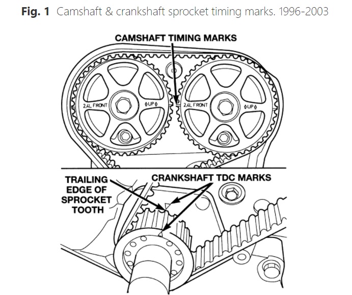

21.On all models, align the crankshaft and camshaft sprocket timing marks, Fig. 1. The trailing edge of the sprocket tooth should be aligned with the oil pump housing mark, or the camshaft marks will be improperly set. When aligning timing marks, always rotate engine from crankshaft.

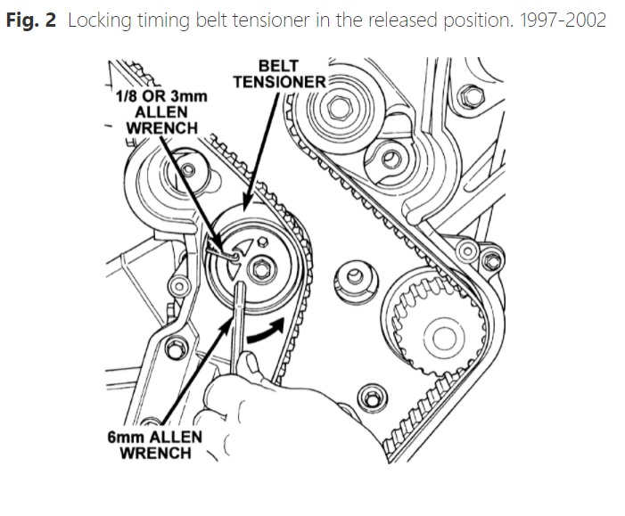

22.On 1997-2002 models, position a 6 mm hex head wrench to the timing belt tensioner pulley. Also insert an 3 mm hex head wrench into the tensioner pulley pin hole, Fig. 2. With the 6 mm hex head wrench, rotate the tensioner pulley counterclockwise until the 3 mm hex head wrench can be inserted into the locking hole on the engine.

26.On all models, ensure the crankshaft sprocket timing mark is properly aligned.

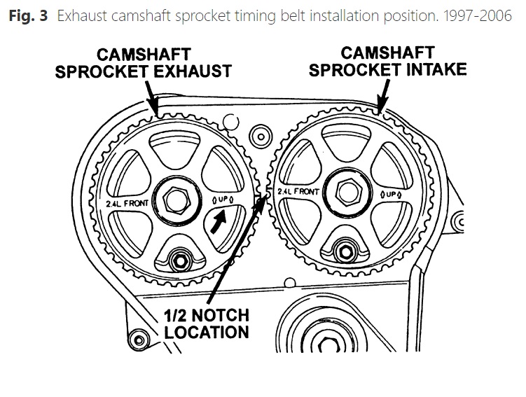

27.Position the camshaft sprocket so the exhaust sprocket is 1/2 notch below the intake sprocket, Fig. 3. Ensure the arrow marks on both camshaft sprockets are facing upward.

29.Rotate the exhaust camshaft sprocket counterclockwise, aligning the timing marks, Fig. 1, to take up the timing belt slack.
30.On 1997-2002 models, remove the 3 mm hex head wrench from the timing belt tensioner pulley hole.

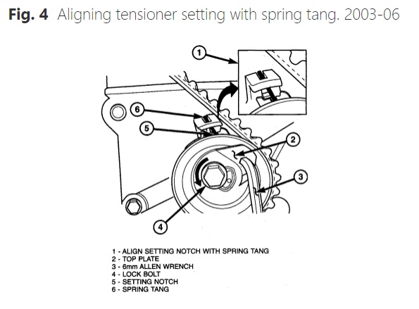

c.The tensioner pulley will move against the timing belt and the tensioner setting notch will start to move clockwise.
d.Continue to rotate the tensioner pulley top plate counterclockwise until the setting notch is aligned with the spring tang, Fig. 4.
e.While holding the pulley top plate in position with the hex wrench, tighten the tensioner lock bolt to 220 inch lbs.
32.Turn the crankshaft pulley two revolutions in the clockwise direction.
33.Inspect the crankshaft and camshaft sprocket timing marks for proper alignment, Fig. 1. If the timing marks are not properly aligned, the timing belt must be removed and installed once again.
34.On 2003-06 models, ensure the tensioner spring tang is within the window on the tensioner, Fig. 5. If not, repeat steps 31 through 33.
