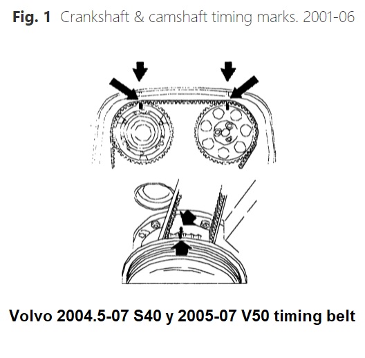

Estoy armando un motor volvo s40 2.4i año 2005 #b5244s, alguien conoce el tiempo de sincronización de este motor.
Hola, te comparto las indicaciones para sincronizar banda de tiempo Volvo S40 2.4L b5244 , espero te sirva
Volvo 2004.5-07 S40 y 2005-07 V50 timing belt
These engines are classified as an Interference engine. If the timing belt breaks or jumps timing, a piston may contact an open valve. Piston to valve contact may cause damage to the valve, piston and other engine components. In some cases valve to valve contact may be experienced when the timing belt breaks or jumps timing. To avoid belt breakage, replace the timing belt as recommended by the vehicle manufacturer timing belt replacement interval.
With the timing belt removed, avoid turning the camshaft or crankshaft. If movement is required, exercise extreme caution to avoid valve damage caused by piston contact.

4.Remove the righthand engine mount limiter pad retaining bolts from the righthand frame member and cylinder head.

12.Turn the crankshaft clockwise to place timing marks at TDC, Fig. 1.

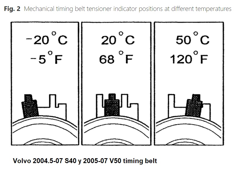

13.Loosen the timing belt tensioner center bolt. It may be necessary to lower the engine slightly to access the timing belt tensioner center bolt.
14.While holding the timing belt tensioner center bolt in position, use a 6 mm hex wrench to move the tensioner eccentric clockwise to the 10 o'clock position.
15.Remove the timing belt.
16.Remove the timing belt tensioner and idler pulleys. The timing belt tensioner and idler pulleys and retaining bolts must always be replaced when replacing the timing belt.
17.Install a new timing belt tensioner pulley and hand tighten retaining bolt. Ensure the tensioner fork is centered over the engine block rib and the hex hole on the eccentric is at 10 O'clock.

21.Turn the crankshaft slightly in the clockwise direction to tension the timing belt between the crankshaft sprocket, idler pulley and intake camshaft sprocket.
22.While holding the timing belt tensioner center bolt, move the eccentric counterclockwise until the tensioner indicator passes the marked position.
23.Turn the eccentric back in the clockwise direction until the needle reaches the marked position corresponding to the relevant temperature, Fig. 2.

25.Ensure that the timing belt tensioner indicator is in the correct position. If not, the timing belt must be tensioned.
26.Press on the timing belt to ensure that the indicator on the timing belt tensioner moves easily.
27.Temporarily install the upper timing cover.
28.Turn the crankshaft clockwise two revolutions aligning the crankshaft and camshaft timing marks.
29.Ensure that the indicator on the timing belt tensioner is within the marked area. If not readjust the timing belt tension.
