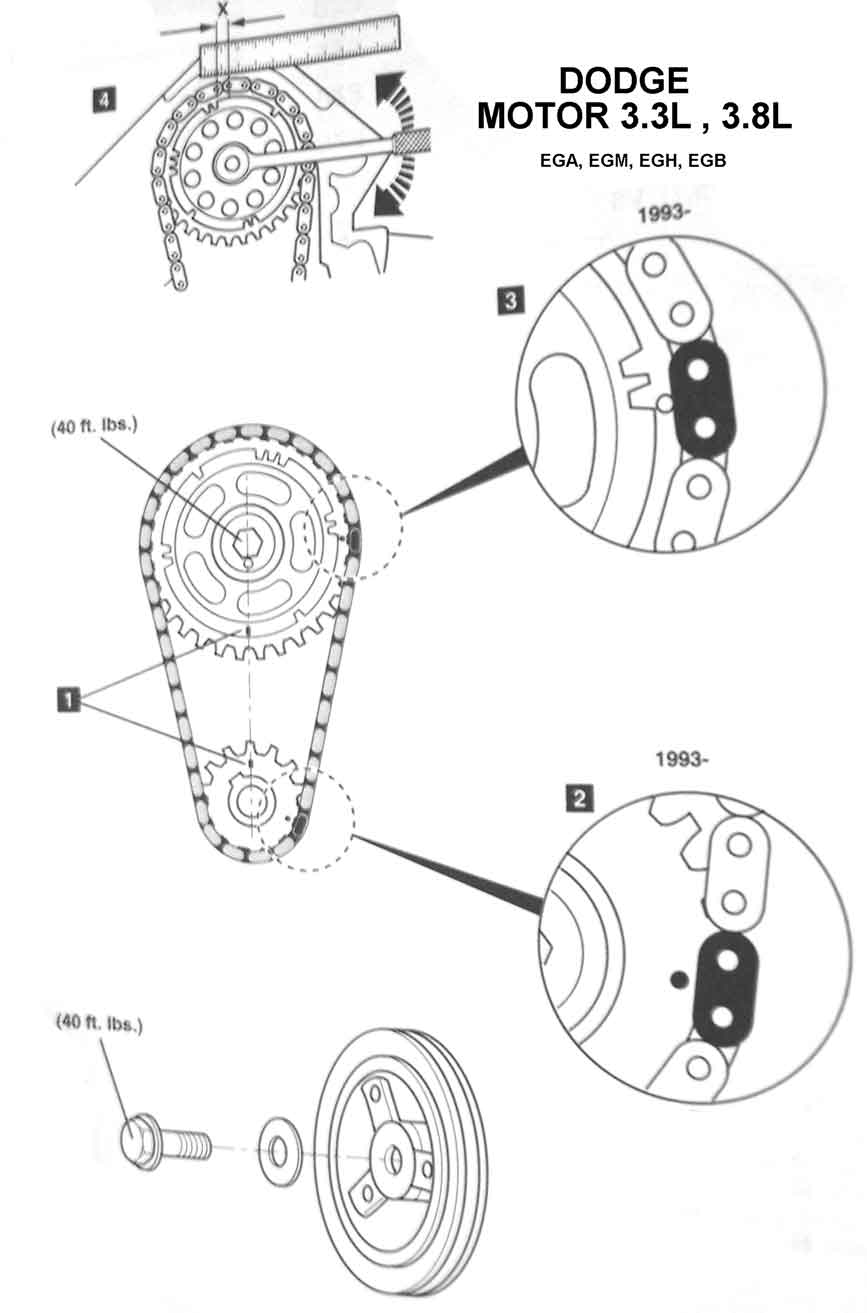

cual es la posision de las poleas de una dodge motor 3.8
lo que pasa es que tiene 2 marcas una de punto y la otra una flecha alguien me podria ayudar como van sincronisadas
DODGE, CARAVAN, DYNASTY, INTREPID, 3.3L Y 3.8L V6 1993-07
Aqui te paso un esquema; espero sea el que ocupas
    48,1 KB · Visitas: 2.772

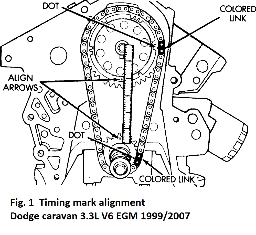

comparto mas informacion de apoyo para poner a tiempo un dodge
Dodge caravan 3.3L V6 EGM 1999/2007
TIMING CHAIN, REPLACE
1.Remove camshaft sprocket attaching cup washer, then remove timing chain with crankshaft and camshaft sprockets.
2.Install new timing chain around both sprockets.
3.Turn crankshaft and camshaft to align keyway locations in both sprockets.
4.Lift sprocket and chain, keeping sprockets tight against chain in position described.
5.Slide both sprockets with chain evenly over their respective shafts, then use a straightedge to verify alignment of timing marks, Fig. 1.
6.Install cup washer and camshaft sprocket bolt.
7.Inspect camshaft endplay. Endplay should measure .005-.012 inch with a new thrust plate or up to .012 inch with a used thrust plate. If camshaft endplay is not as specified, replace thrust plate.
8.Install timing chain cover.
9.Reverse procedure to install, note following:
a.Torque timing chain cover M8 bolts to 20 ft. lbs.; M10 bolts to 40 ft. lbs.
b.Torque camshaft sprocket bolts to 40 ft. lbs.
