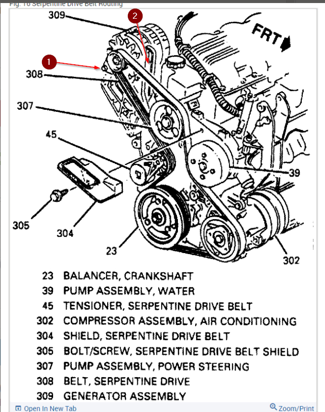

Cambiando el alternador de un OLDSMOBILE CUTLASS 3.0L V6 1994
Instrucciones en ingles
1. Disconnect battery ground cable.
2. Disconnect blower motor electrical connections.
3. Remove serpentine drive belt, then the alternator bracket bolts. Position alternator aside.
4. Remove vent tube.
5. Remove blower motor attaching screws, then the blower motor.
6. Reverse procedure to install.
