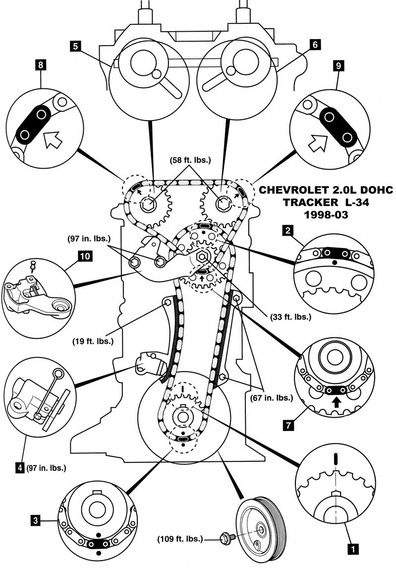

Buenas por favor necesito ayuda para sincronizar las cadenas de una gran vitara 2.0 año 2001, si serian tan amables de facilitarme un esquema se los agradezco
Tengo el del grand vitara JLS 2001 me avisas si te sirve para mandartelo, de echo lo iba a subir de una vez pero no se como subir imagenes
Yo tengo esta info por si alguien la ocupa - reemplazo cadena de tiempo
TIMING CHAIN, REPLACE
Vitara 2.0L 1999/2003
REMOVAL
1.Remove front timing chain cover.
2.Turn crankshaft clockwise and align timing marks on CMP actuator and exhaust camshaft timing sprocket with match marks on camshaft housing No. 1, Fig. 1.
3.Align timing mark on crankshaft timing sprocket with match mark on lower crank case, Fig. 1.
4.Remove timing chain tensioner adjuster, then tensioner.
5.Remove timing chain guide and timing chain.
INSTALLATION
1.Align timing mark on CMP actuator and exhaust camshaft timing sprocket with match marks on camshaft housing, Fig. 1.
2.Align timing mark on crankshaft timing sprocket with match mark on lower crank case, Fig. 1.

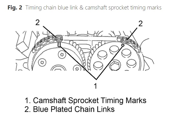

3.Install timing chain aligning two blue plates with timing marks on CMP actuator and exhaust camshaft timing sprockets, Fig. 2.
4.Align blue plate on timing chain with timing mark on crankshaft timing sprocket.
5.Install timing chain guide. Torque timing chain guide to No. 1 bolts to 84 inch lbs.
6.Apply clean engine oil to sliding surface of timing chain guide.
7.Attach spacer to timing chain tensioner, then install tensioner. Torque timing chain tensioner to 18 ft. lbs.
8.Ensure all timing marks are aligned, Fig. 1.

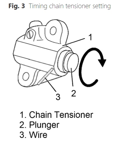

9.Screw in plunger of tensioner adjuster clockwise, then install a suitable piece of wire to hold plunger in place, Fig. 3.
10.Install timing chain tensioner adjuster, then remove retainer. Torque timing chain tensioner adjuster bolt to 102 inch lbs.
11.Apply clean engine oil to timing chain, then turn crankshaft clockwise two complete revolutions and ensure timing marks on CMP actuator and exhaust camshaft timing sprocket are aligned with match marks camshaft housing No. 1.
12.Ensure timing mark on crankshaft timing sprocket is aligned with match mark on lower crank case, Fig. 1.
13.Install front timing chain cover.
