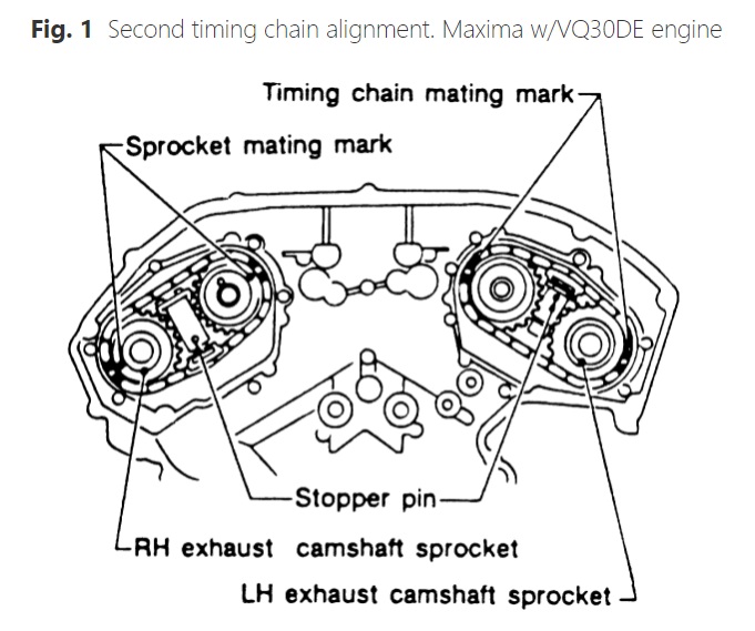

2.Install lower chain guide on dowel pin with front mark on guide facing upside.
3.Align marks on second chain intake and exhaust camshaft sprockets, and second camshaft chain, Fig. 1.
4.Install intake and exhaust camshaft sprockets. Exhaust sprocket is thicker than intake.
5.Remove camshaft tensioner stopper pins.

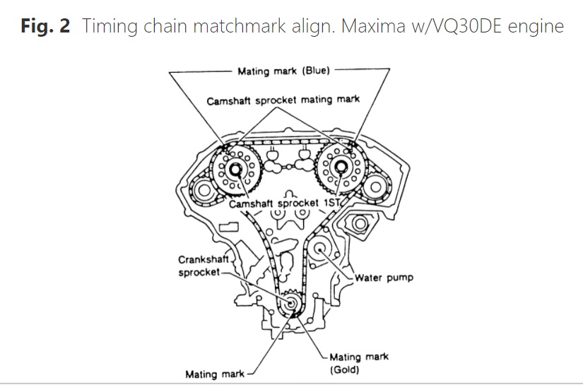

6.Align crankshaft sprocket mating mark with chain gold matchmark, Fig. 2.
7.Attach lower timing chain on water pump sprocket.
8.Install first chain camshaft sprockets onto timing chain by matching sprocket dowel grooves with camshaft and tighten bolts to specifications.
9.Install timing chain, ensuring mating marks and matchmarks are aligned.

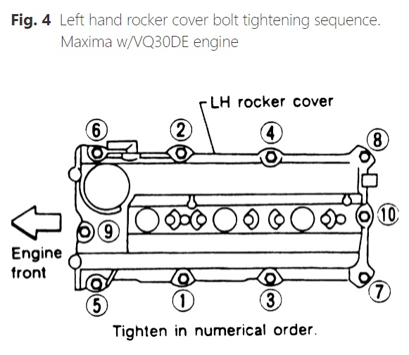

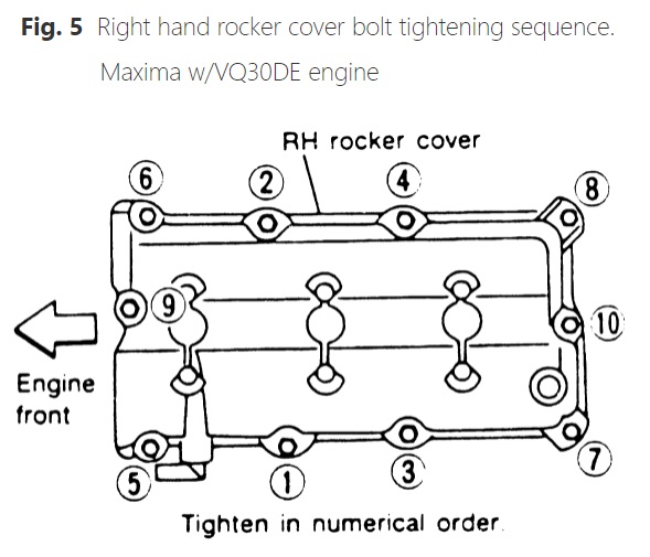

12.Torque bolts 1 and 2 to 18.8-23.1 ft. lbs. and bolts 3-20 to 8.7-10.1 ft. lbs. in sequence shown in Fig. 3.
13.Apply liquid gasket to water pump cover and install.
14.Apply liquid gasket to rocker covers and install.
15.Torque rocker cover bolts to .7-2.2 ft. lbs. in sequence shown in Figs. 4 and 5, then torque bolts to 4.3-5.8 ft. lbs.
