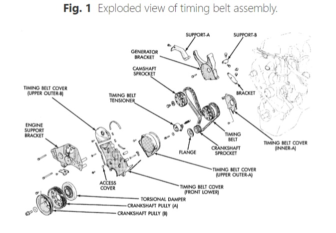

7.Remove the crankshaft drive pulleys and the torsional damper, Fig. 1.
8.Place a suitable jack and wooden block under the engine and raise slightly, then remove the engine mount bracket.
9.Remove the timing belt cover, Fig. 2.
10.Loosen the timing belt tensioner, then remove the crankshaft sprocket flange shield and the timing belt.

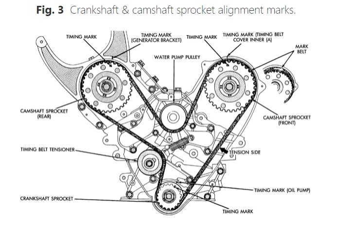

11.To install, ensure all timing marks are properly aligned, then place the new timing belt on the crankshaft sprocket first. Keep the belt tight on the tension side and install the belt on the lefthand camshaft sprocket.
12.Install the belt on the water pump pulley, then on the righthand camshaft sprocket and the belt tensioner.
13.Apply rotating force to the front camshaft sprocket in opposite direction to tighten the tension side of the belt, then ensure all the timing marks are properly aligned, Fig. 3.
14.Install the crankshaft sprocket flange shield, then loosen the tensioner bolt and turn the crankshaft two full turns clockwise.
15.Inspect the timing marks once again, then torque the tensioner lock bolt to 21 ft. lbs.
