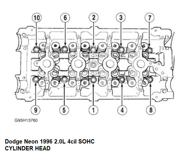

Torque de cabeza para Dodge Neon 1996 2.0L 4cil SOHC

5. To install, reverse removal procedure. Clean and oil bolt threads before installation. Short bolts
should be installed in positions No. 7, 8, 9 and 10. See Fig. 3 . Tighten head bolts in sequence
using 4-step torque/turn method.
1st: tighten to 25 ft. lbs. (34 N.m).
2nd: tighten to 50 ft. lbs. (68 N.m).
3rd: tighten to 50 ft. lbs. (68 N.m).
4th: tighten an additional 1/4 turn (DO NOT use a torque wrench for 4th step).
