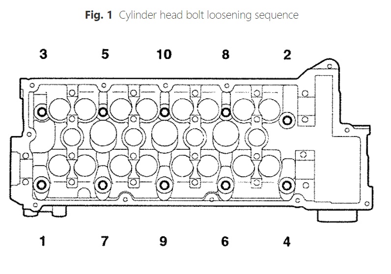

12.Remove cylinder head bolts, then head assembly using sequence outlined in Fig. 1, then tool No. 09221-21000 on SOHC engine or tool Nos. 09221-32001 and 09221-11000 on DOHC engine, or equivalents.

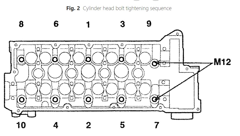

4.Tighten cylinder head bolts using sequence outlined, Fig. 2.
a.Tighten .4 inch cylinder head bolts in three steps: 1st step, torque bolts to 22 ft. lbs.; 2nd step, tighten bolts an additional 60-65°; 3rd step, tighten bolts an additional 60-65.°
b.Tighten .47 inch cylinder head bolts in three steps: 1st step, torque bolts to 26 ft. lbs.; 2nd step, tighten bolts an additional 60-65°; 3rd step, tighten bolts an additional 60-65.°
    121,1 KB · Visitas: 736
    156,8 KB · Visitas: 2.362
