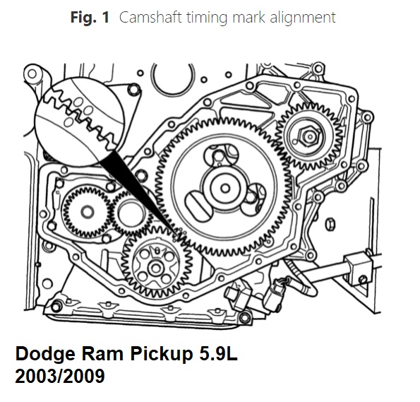

esquema de sincronizacion de dodge ram 3500 5.9
No pusieron año, comparto esta por si alguien la ocupa, Dodge Ram Pickup 5.9L 2003/2009
TIMING CHAIN, REPLACE

13.Remove pump gear access cover by rotating counterclockwise.
14.Rotate crankshaft to bring engine to TDC No. 1 using engine barring tool No 7471B, or equivalent.
15.Remove gear cover to housing bolts and gently pry cover away from housing.

19.Verify camshaft timing marks are aligned with crankshaft and injection pump marks.

22.Reverse procedure to install, note following:
a.Align timing marks, Fig. 1.
b.Torque gear housing to 18 ft. lbs.
