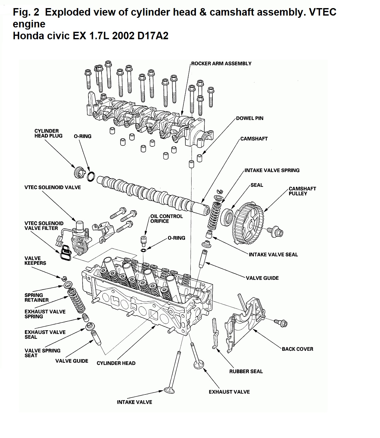

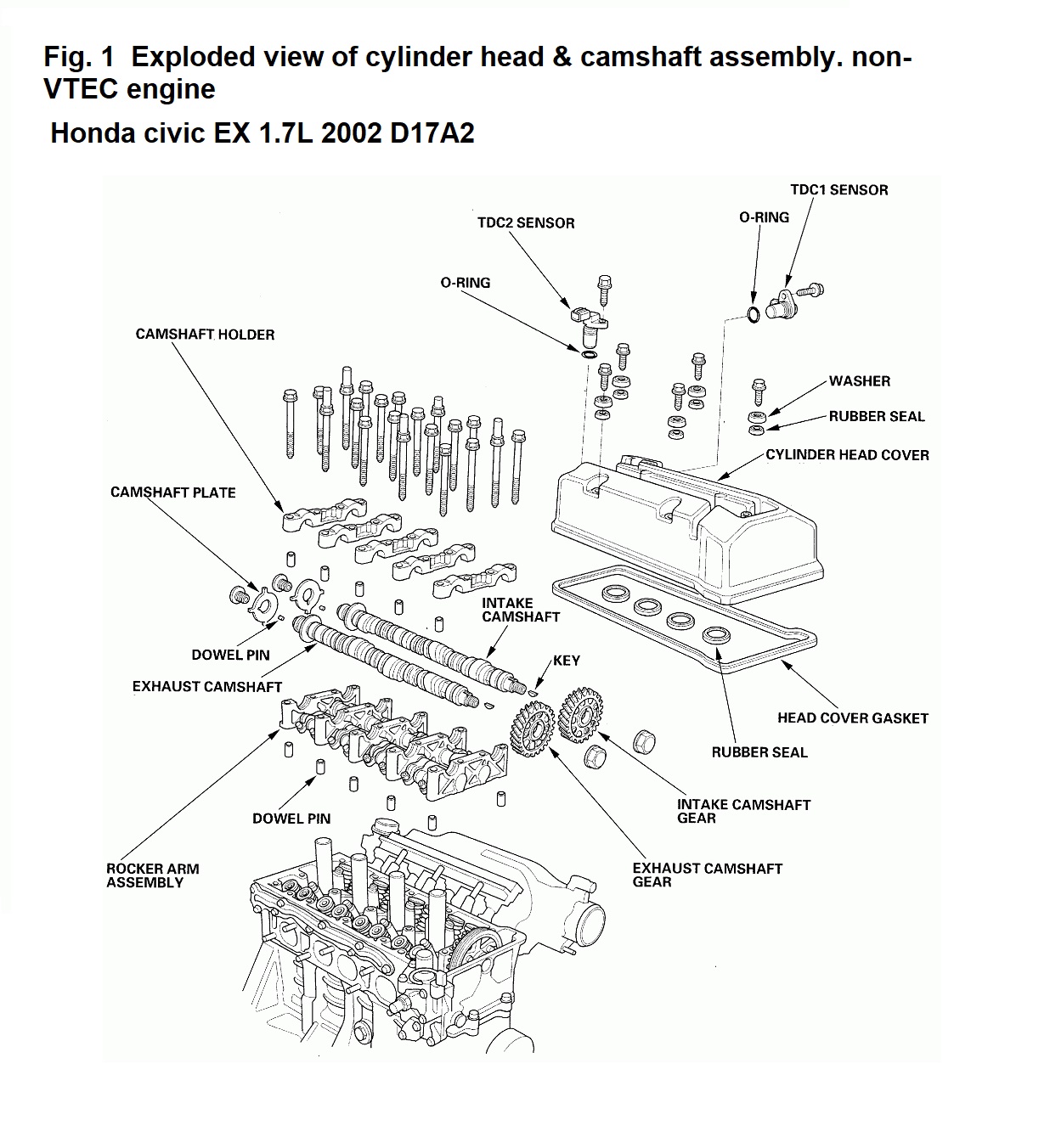

15.Remove belt from camshaft pulleys, then the pulleys, Figs. 1 and2.
16.Loosen adjustment screws and camshaft holders, then remove camshafts and rocker arms.

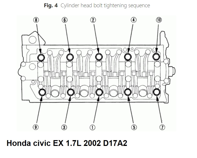

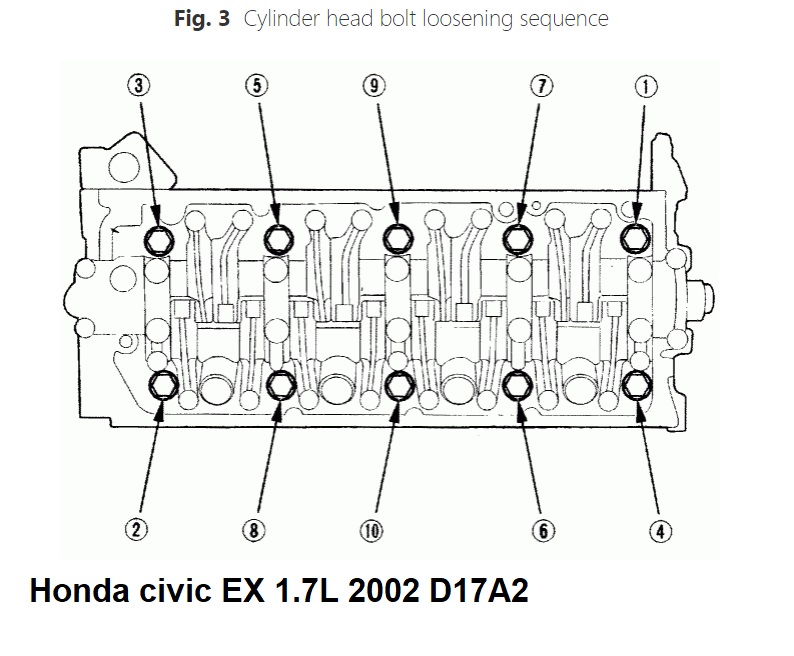

17.Remove cylinder head bolts in sequence, Fig. 3,1/3 turn at a time until all bolts are loosened.
18.Remove cylinder head from engine block.
19.Remove intake and exhaust manifolds from cylinder head.
20.Reverse procedure to install, noting the following:
a.Using sequence illustrated in Fig. 4,torque cylinder head bolts in three steps: 1st step, 14 ft. lbs.; 2nd step, 36 ft. lbs.; 3rd step, 49 ft. lbs.
b.Install exhaust manifold and tighten with new self-locking nuts in a crisscross pattern in two or three steps, beginning with inner nuts.
