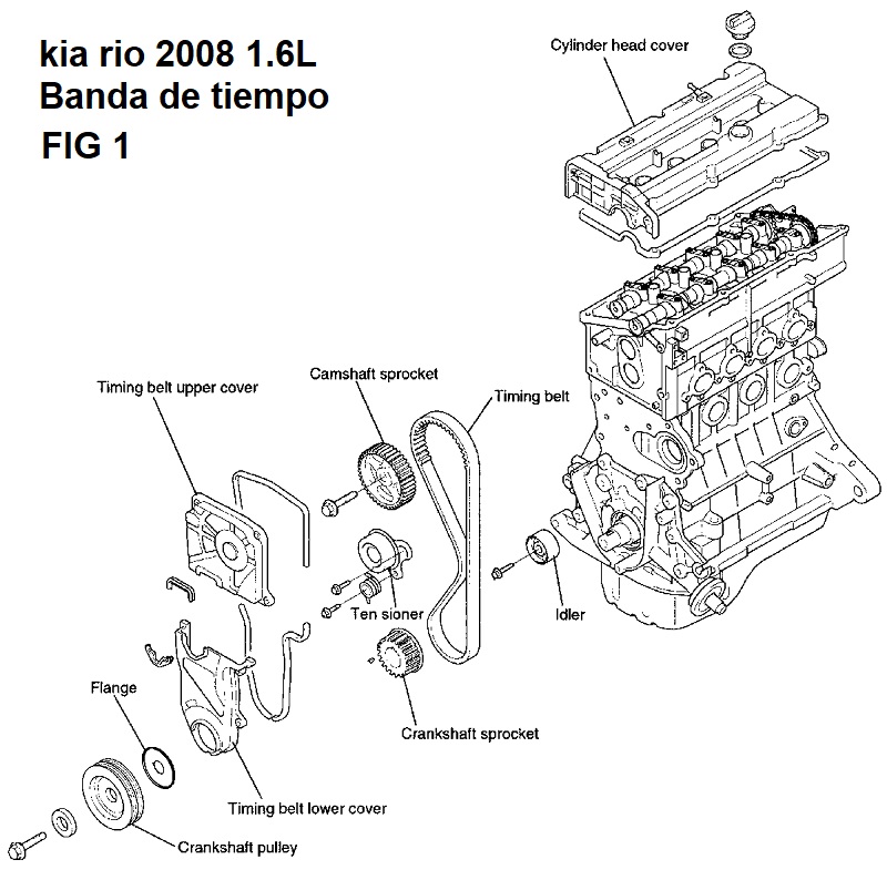

11.Remove the four upper timing belt cover attaching screws, then the cover, Fig. 1.

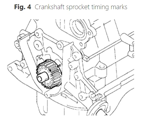

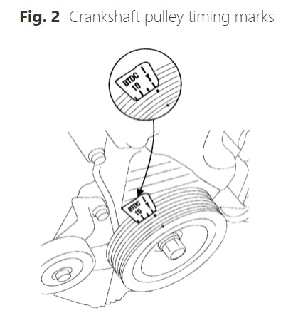

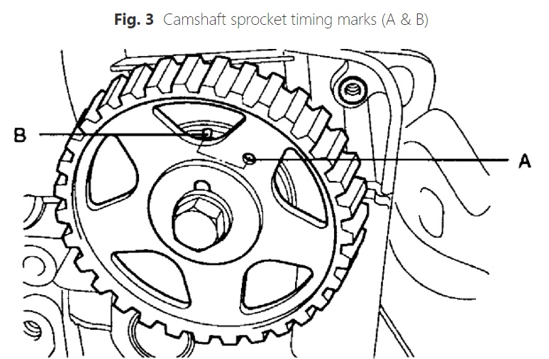

12.Align the crankshaft pulley and camshaft sprocket timing marks, Figs. 2 and 3.

18.Ensure the camshaft and crankshaft sprocket timing marks are aligned, Figs. 3 and 4.
19.Install the new timing belt over the crankshaft sprocket, idler pulley, camshaft sprocket and the tensioner pulley. Ensure there is no belt looseness between any components.

23.Align the crankshaft and camshaft timing marks, Figs. 3 and 4. If the timing marks do not align, the timing belt must be removed and re-installed.

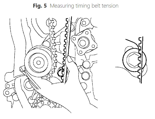

24.Verify that when the tensioner and tension side of the timing belt are pushed in horizontally with a force of approximately 11 lbs., the timing belt cog end is approximately 1/2 of the tensioner mounting bolt head radius (across flats) away from the bolt center, Fig. 5.
25.Align the crankshaft and camshaft timing marks, Figs. 3 and 4. If the timing marks do not align, the timing belt must be removed and re-installed.
