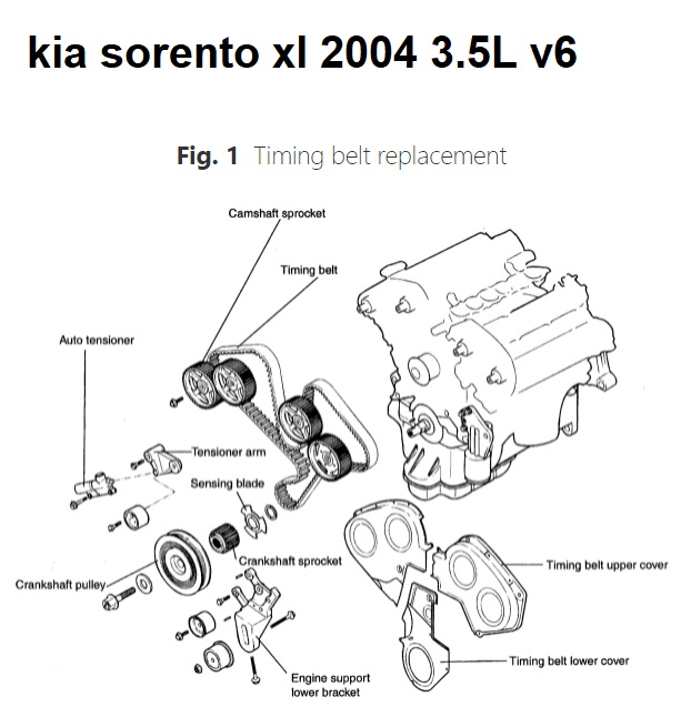

5.Remove the timing belt upper and lower covers, Fig. 1.

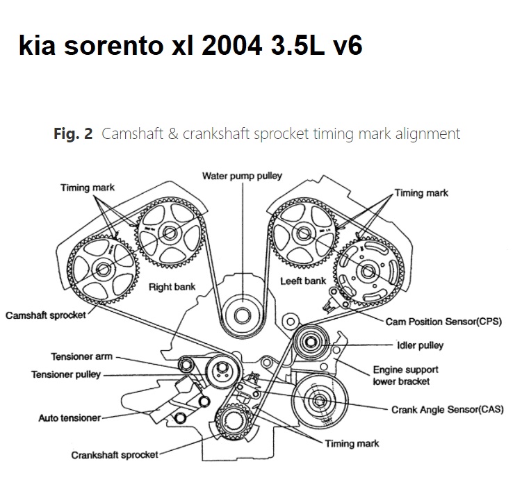

6.Rotate the crankshaft clockwise to align the crankshaft and camshaft timing marks and set the No. 1 piston at TDC compression stroke, Fig. 2.

10.Install the idler pulley to the engine support lower bracket.
11.Install the tension arm, shaft and plain washer to the engine block. Torque the bolt to 26-40 ft. lbs.

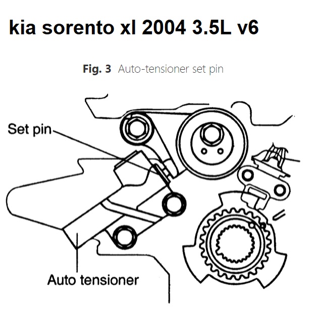

12.Retract the auto-tension rod, then use a suitable pin to lock the rod in the retracted position.
13.Install the auto-tensioner to the oil pump case. Torque the bolts to 15-20 ft. lbs.
14.Ensure the crankshaft and camshaft sprocket timing marks are aligned.
15.Install the new timing belt over the crankshaft sprocket, idler pulley, lefthand exhaust camshaft sprocket, lefthand intake camshaft sprocket, water pump pulley, righthand intake camshaft pulley, righthand exhaust camshaft sprocket and the tensioner pulley.

18.Ensure the crankshaft and camshaft sprocket timing marks are aligned.
19.Remove the set pin from the auto-tensioner, Fig. 3.
20.Rotate the crankshaft 2 turns clockwise, aligning the crankshaft and camshaft sprocket timing marks. Ensure No. 1 cylinder is at TDC compression stroke.

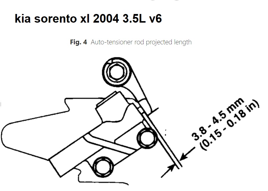

21.After waiting approximately five minutes, with No. 1 cylinder still at TDC compression stroke, measure the auto-tensioner rod projected length, which should be .15-.18 inch, Fig. 4.
22.If the auto-tensioner rod projected length is not within range, remove and install the timing belt once again.
23.Ensure the crankshaft and camshaft sprocket timing marks are still aligned. If the marks are not aligned, the timing belt must be removed and installed once again.
