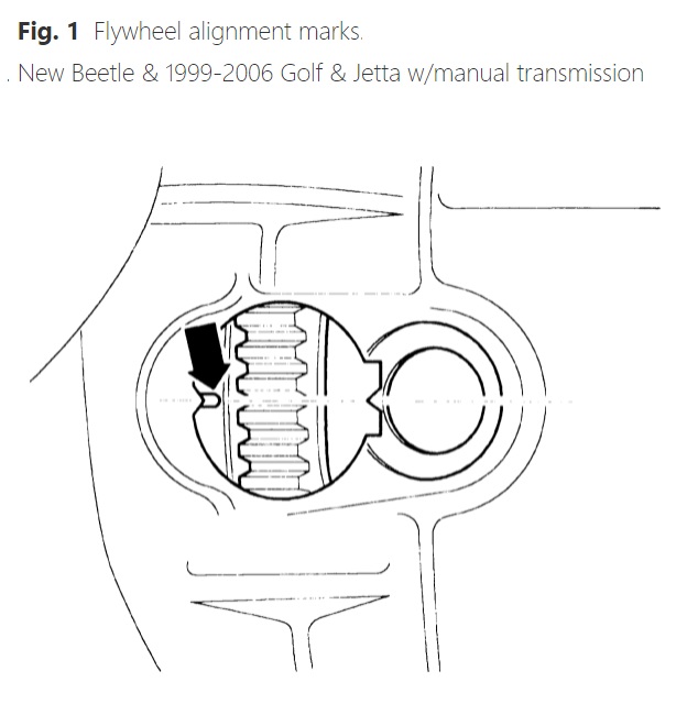

11.On models equipped with manual transmission,rotate the crankshaft in the normal running direction until the No. 1 cylinder reaches TDC compression stroke and the flywheel timing marks are properly aligned, Fig. 1.

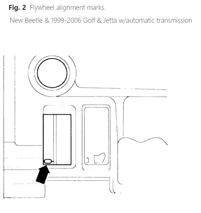

12.On models equipped with automatic transmission,rotate the crankshaft in the normal running direction until the No. 1 cylinder reaches TDC compression stroke and the flexplate timing marks are properly aligned, Fig. 2.

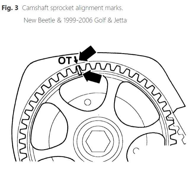

14.Ensure the camshaft sprocket timing marks are properly aligned, Fig. 3.

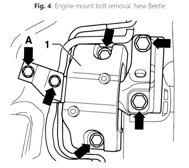

18.On New Beetle models, remove the four engine mount bolts (1), Fig. 4, then loosen, but do not remove, bolt "A."

24.Ensure all the timing marks are still properly aligned, Figs. 1 through 3. If alignment of the camshaft sprocket timing marks is required, turn crankshaft back slightly. If piston is at TDC, the valve could strike the piston. After aligning the camshaft sprocket timing marks, align the crankshaft timing marks.

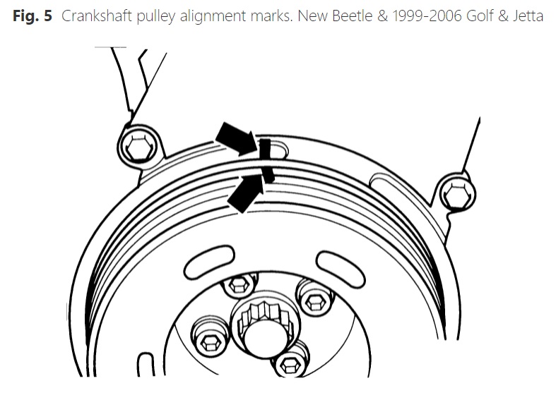

30.Ensure the crankshaft pulley timing marks are properly aligned, Fig. 5.

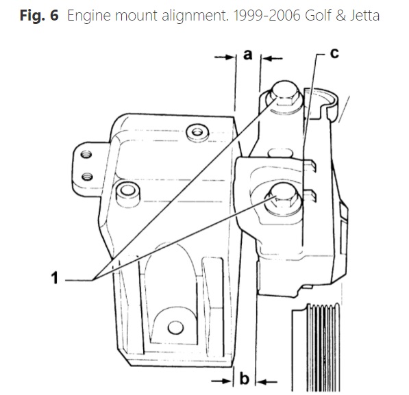

32.On Golf and Jetta models, ensure the mount is properly aligned, Fig. 6.
a.The bolt heads (1) must align with the edge of the mount "C."
b.Dimension "A" must be 0.55 inch.
c.Dimension "B" must be at least 0.40 inch.
d.Torque M6 bolts to 84 inch lbs.
e.Torque M8 bolts to 18 ft. lbs.
f.Torque M10 bolts to 30 ft. lbs.
g.Torque M12 bolts to 44 ft. lbs.
33.On New Beetle models, proceed as follows:
a.Torque the mount to body bolts to 30 ft. lbs., then rotate an additional 90°.
b.Torque the mount bracket to body bolt "A,"Fig. 4, to 18 ft. lbs.
c.Torque the mount to engine bracket bolt to 44 ft. lbs., then rotate an additional 90°.

35.Ensure all the timing marks are properly aligned, Figs. 1 through 3.

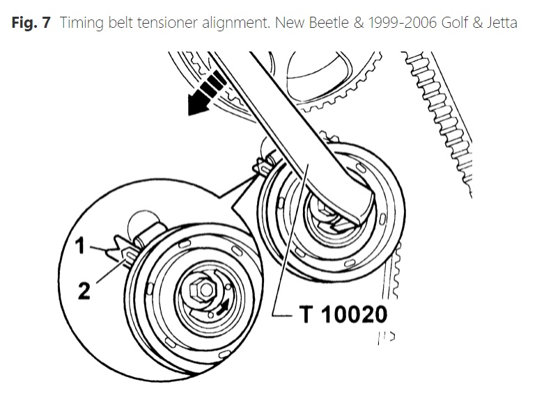

36.Loop the timing belt around the camshaft sprocket and tensioner roller.
37.Rotate the timing belt tensioner counterclockwise until the notch (1) and indicator (2) are aligned using VW wrench tool No. T 10020, or equivalent, Fig. 7. Use a suitable mirror for this inspection. The angled retainer must also be securely located in the cylinder head cutout.
38.Torque the tensioner mounting nut to 15 ft. lbs.
39.Rotate the crankshaft two turns in the normal direction of rotation. The timing belt tensioner notch (1) and indicator (2) must move back into proper alignment, Fig. 7. It is important that the last 1/8 turn of rotation is made without interruption.
