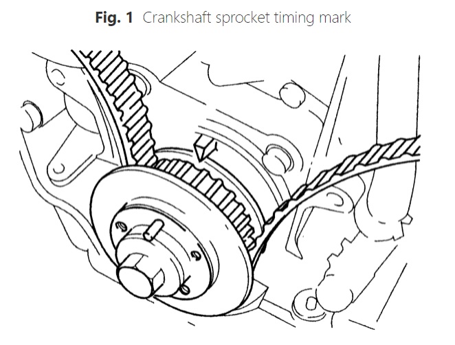

7.Turn the crankshaft clockwise, aligning the crankshaft sprocket timing mark with the engine timing mark, Fig. 1.

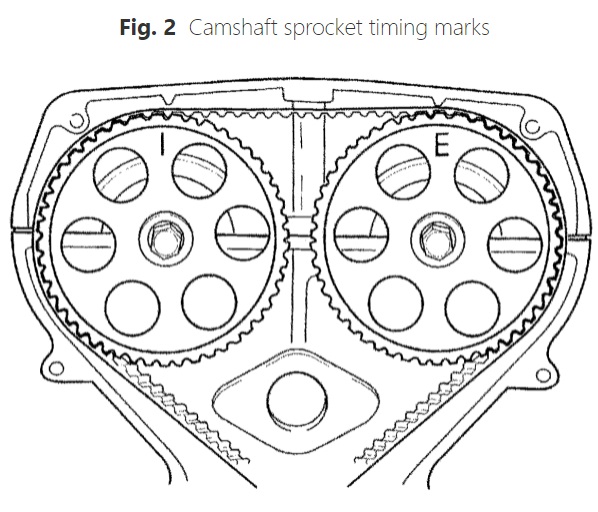

8.Ensure the intake camshaft sprocket "I" mark and exhaust sprocket "E" mark are aligned with the cylinder head cover marks, Fig. 2.

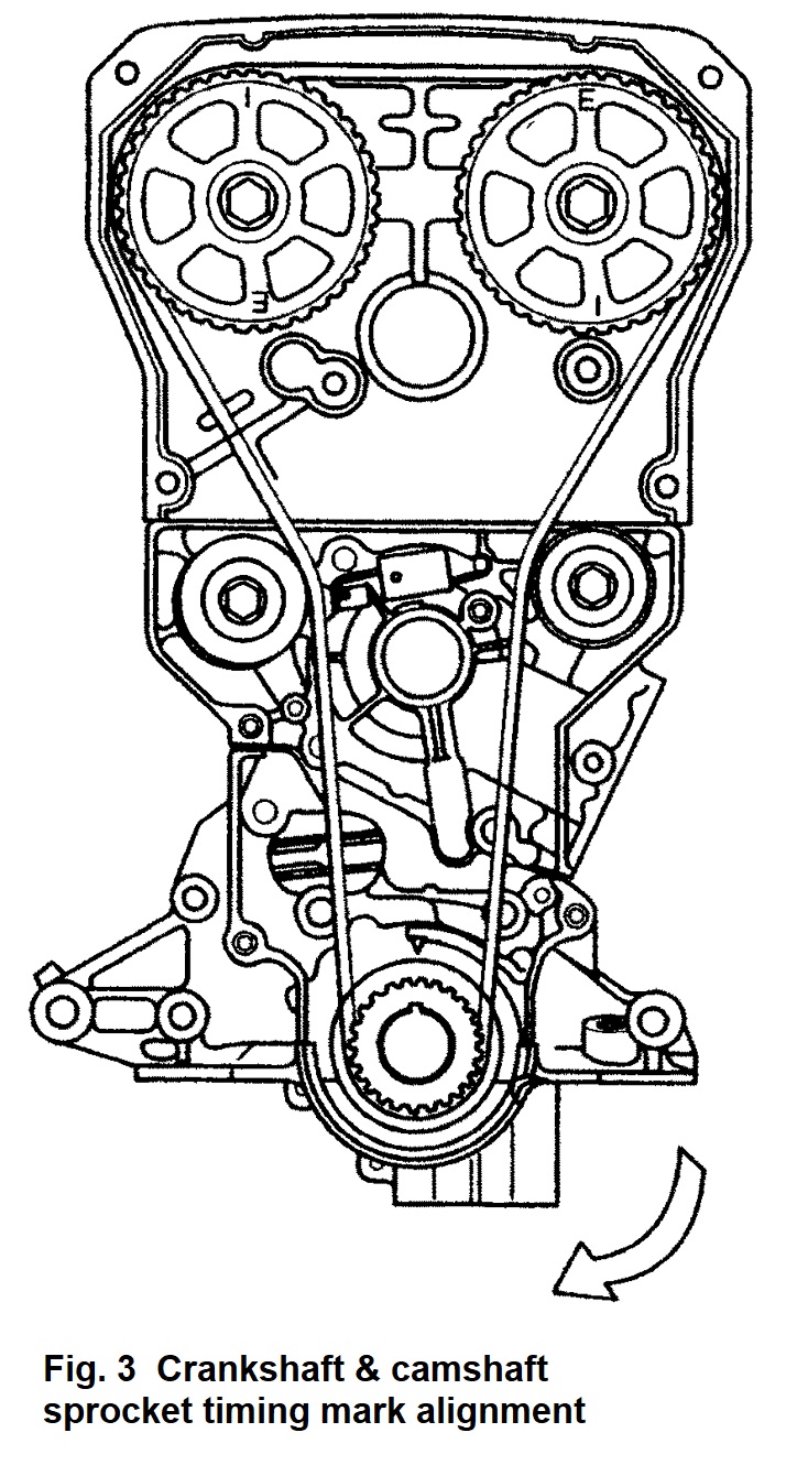

13.Ensure the crankshaft and camshaft sprocket timing marks are aligned, Fig. 3.
14.Install timing belt over the crankshaft sprocket, idler pulley, exhaust camshaft sprocket, intake camshaft sprocket and the tensioner pulley.
15.Ensure there is slack in the timing belt between the idler pulley and exhaust camshaft sprocket or between intake and exhaust camshaft sprockets.
16.Loosen the timing belt tensioner pulley lock bolt and allow the tensioner spring to tension the timing belt. Do not add any additional force to the tensioner.
17.Torque the timing belt tensioner pulley lock bolt to 28-38 ft. lbs.
18.Rotate crankshaft two full clockwise revolutions, aligning the timing marks, Fig. 3.
19.Inspect the camshaft sprocket timing marks. If the marks are not aligned, remove the timing belt and install once again.
