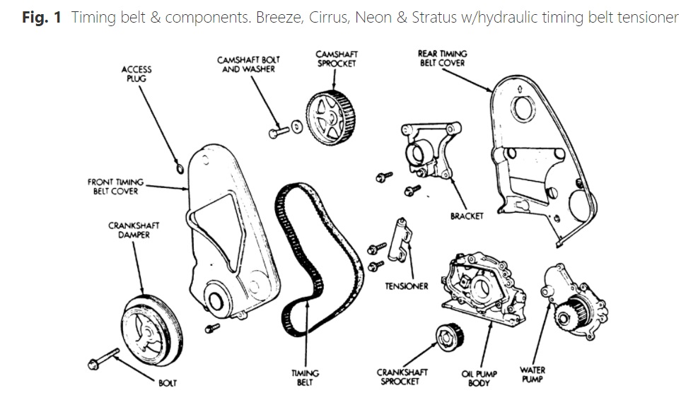

7.Remove the crankshaft damper retaining bolt, Figs. 1 and 2.
8.Remove the crankshaft damper using DaimlerChrysler tool Nos. 1026 and 6827-A, or equivalents.

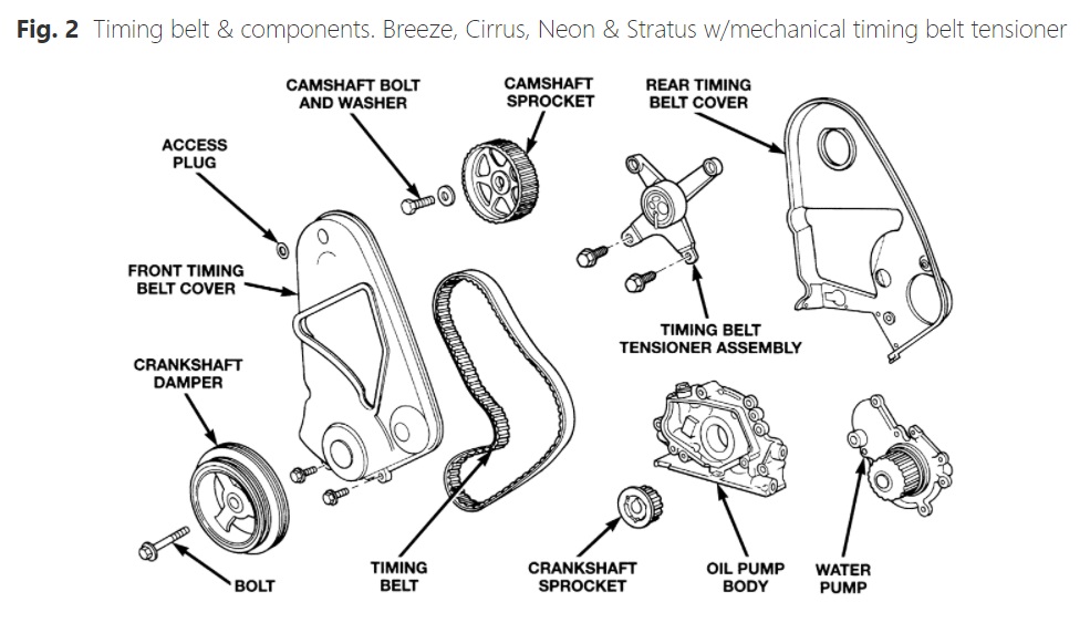

14.Remove the timing belt outer cover.
15.Disconnect spark plug cables from spark plugs, then remove the spark plugs. Tag the spark plug cables and spark plugs so they can be installed at the same locations.

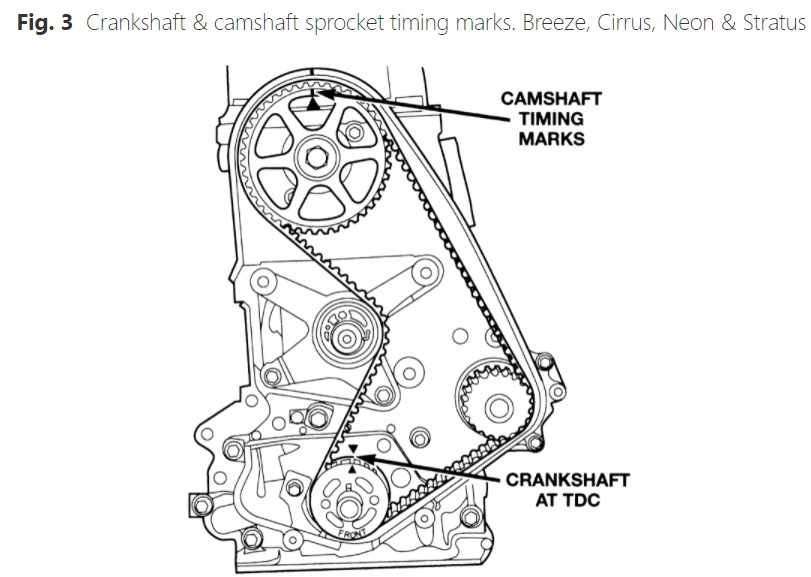

16.Align the crankshaft and camshaft sprocket timing marks before removing the timing belt by rotating the crankshaft. Fig. 3.

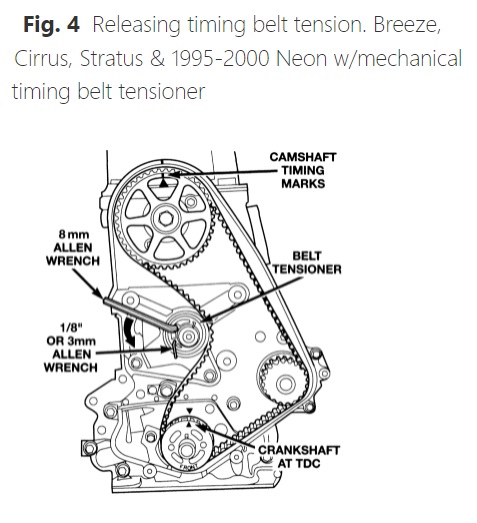

18.On 2000 models equipped with a mechanical timing belt tensioner, proceed as follows:
a.Do not separate the tensioner pulley from its mounting bracket.
b.Insert an 8 mm hex wrench into the tensioner, Fig. 4.
c.Insert the long end of a 1/8 inch or 3 mm hex wrench into the pin hole on the front of the tensioner.
d.Rotate the tensioner counterclockwise with the hex wrench while pushing in lightly on the 1/8 inch or 3 mm hex wrench until it slides into the locking hole.

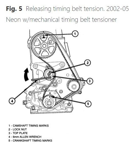

19.On 2002-05 models equipped with a mechanical timing belt tensioner, proceed as follows:
a.Loosen the timing belt tensioner lock nut.
b.Insert an 6 mm hex wrench into the tensioner top plate, Fig. 5.
c.Rotate the tensioner plate clockwise to relieve timing belt tension.
20.On all models, remove the timing belt.

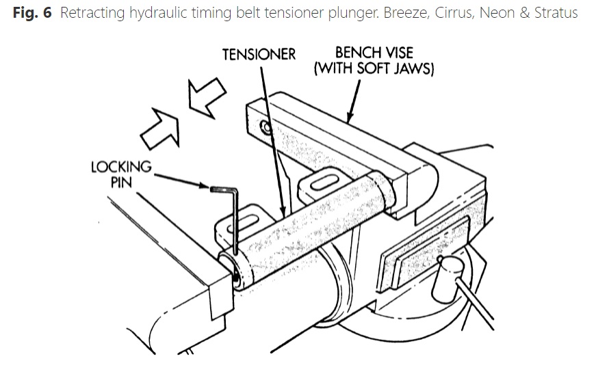

b.Position the tensioner in a soft-jawed vise. Place the tensioner in the vise the same way as it is installed on the engine. This ensures proper pin orientation for easier installation.
c.Slowly compress the tensioner rod.
d.After the tensioner rod has been compressed, insert a 5/64 inch hex wrench through the tensioner body hole to retain the plunger in position, Fig. 6.
e.Remove the tensioner from the vise.

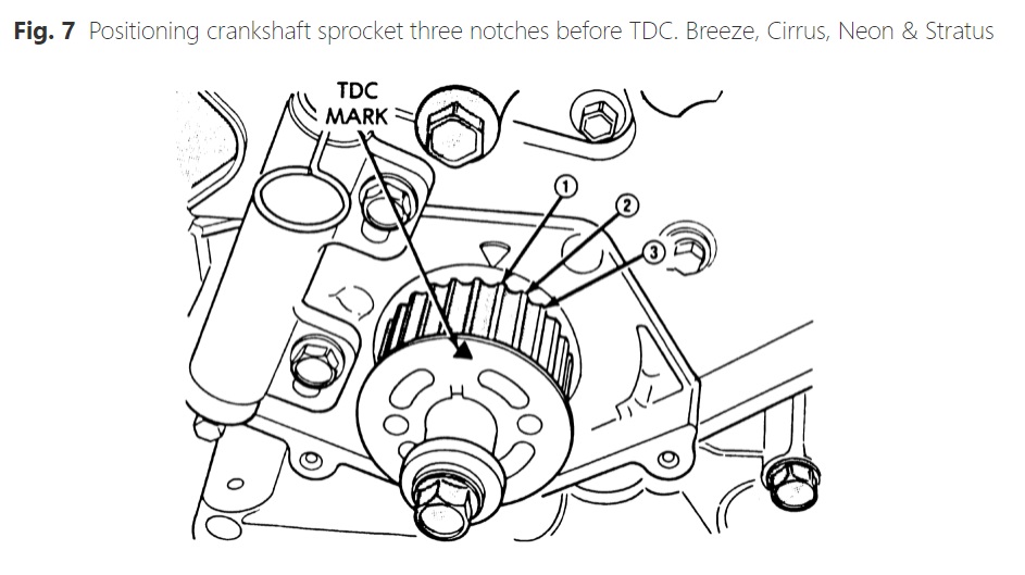

22.On all models, set the crankshaft sprocket to TDC by aligning the sprocket mark with the oil pump housing mark, then back the crankshaft sprocket off TDC by three notches, Fig. 7.

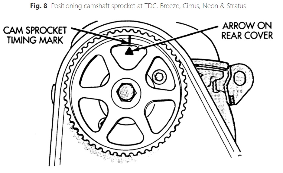

23.Set the camshaft sprocket to TDC by aligning the sprocket mark with the mark on the rear timing belt cover, Fig. 8.

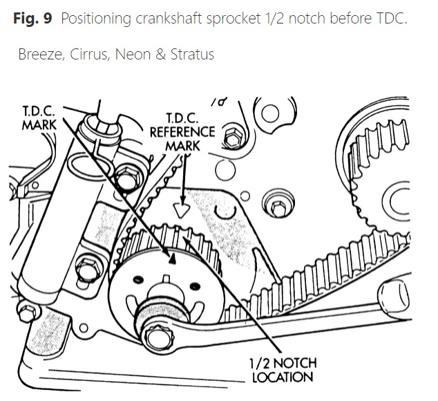

24.Move the crankshaft sprocket to 1/2 notch before TDC, Fig. 9.
25.Install the timing belt over the crankshaft sprocket, water pump sprocket, camshaft sprocket and under the tensioner pulley.
26.Move the crankshaft sprocket 1/2 notch to the TDC position.

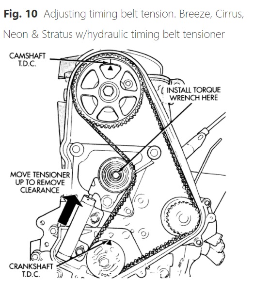

b.Apply approximately 21 ft. lbs., of torque using a suitable torque wrench to the belt tensioner pulley, Fig. 10.
c.With torque being applied to the tensioner pulley, move the tensioner against the tensioner pulley bracket. Torque the tensioner retaining screws to 23 ft. lbs.

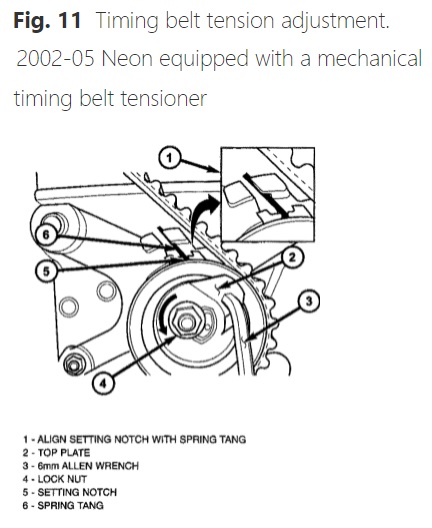

29.On 2002-05 models equipped with a mechanical timing belt tensioner, proceed as follows:
a.Insert a 6 mm hex wrench into hexagon opening located on top plate of belt tensioner pulley.
b.Rotate the top plate counterclockwise, the tensioner pulley will move against timing belt and the tensioner and setting notch will eventually start to move clockwise.
c.Watching the movement of setting notch, continue rotating the top plate counterclockwise until setting notch is aligned with spring tang, Fig. 11.
d.Torque tensioner lock bolt to 22 ft. lbs., while using the 6 mm hex wrench to prevent top plate from moving.
30.On all models, rotate the crankshaft two turns clockwise. Ensure the crankshaft and camshaft sprocket timing marks are aligned, Fig. 3. If not, the timing belt will have to be removed and installed again.

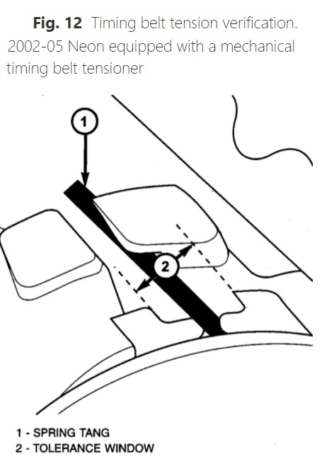

31.On 2002-05 models, ensure spring tang is within the tensioner tolerance window, Fig. 12. If spring tang is not within tolerance window, repeat steps 29 through 31.

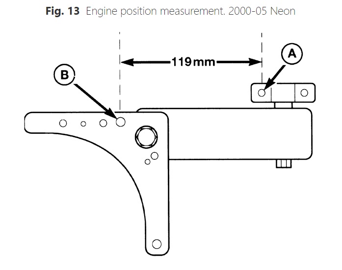

c.Carefully apply upward force, allowing the upper engine to rotate rearward until the distance between the center of the rear most attaching stud on the engine mounting bracket (A) and the center hole for the washer hose clip on the shock tower bracket (B) is 4.70 inches (119 mm), Fig. 13. Hold the engine in this position.
