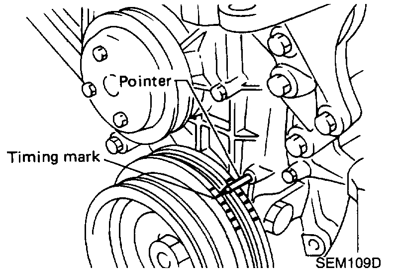

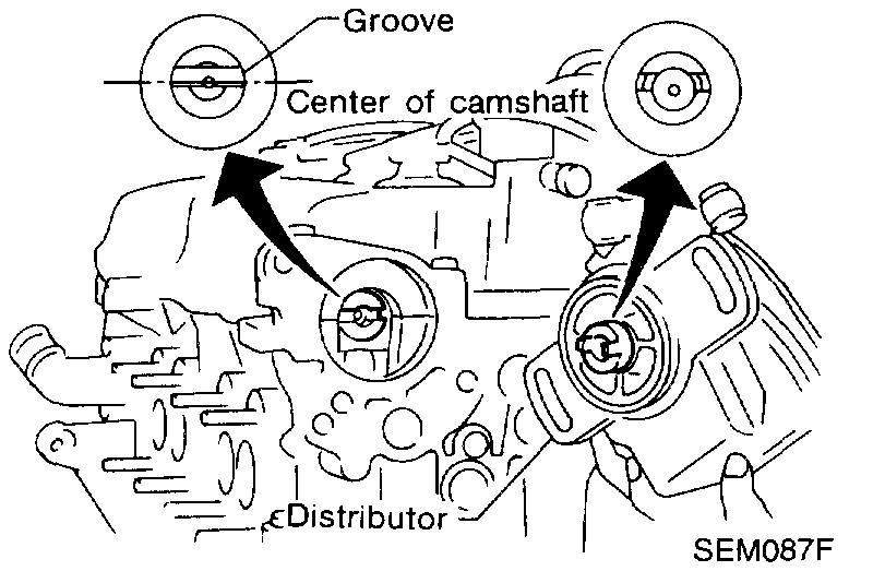

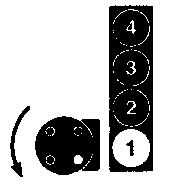

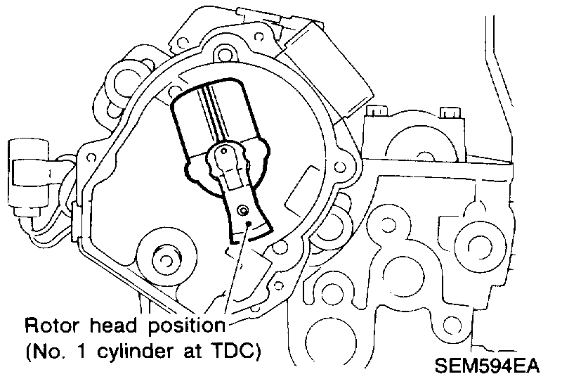

For distributor removal and installation, refer to the following images.
Timing Mark For No.1 Cylinder TDC (Compression Stroke)
(Imagenes 1 a 4)
Hold down bolt torque: 16 - 19 ft. lbs.
