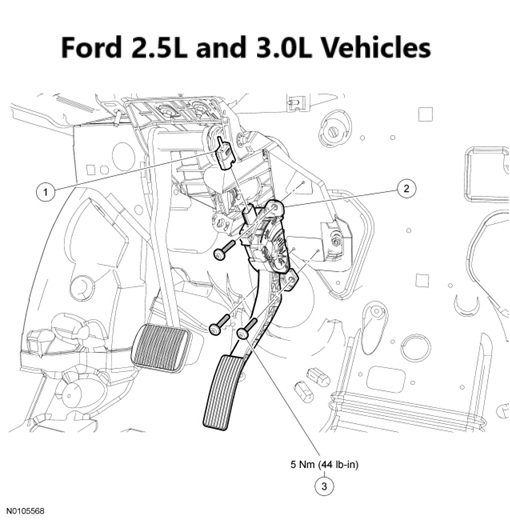

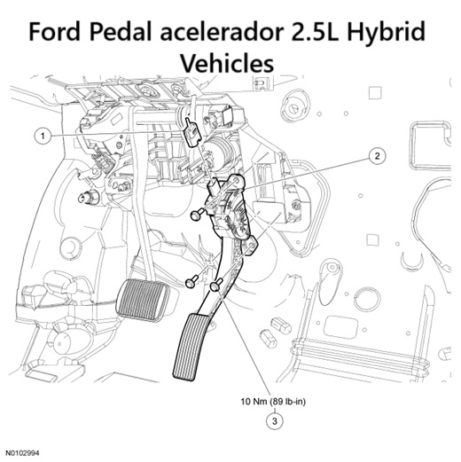

The accelerator pedal and sensor assembly on the 2.5L and 3.0L are similar in appearance to the 2.5L Hybrid but are not interchangeable.
  1. Disconnect the battery ground cable. For additional information, refer to Section 414-01.
2.5L and 3.0L vehicles
  1. Remove the 3 self-tapping screws and the accelerator pedal and sensor assembly.
    • To install, tighten to 5 Nm (44 lb-in).
2.5L Hybrid vehicles
  1. Remove the 3 bolts and the accelerator pedal and sensor assembly.
    • To install, tighten to 10 Nm (89 lb-in).
All vehicles
  1. To install, reverse the removal procedure.
