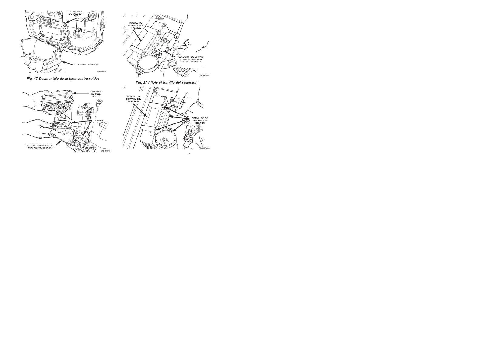

the TCM located on the right side underhood fenderwell.it use 60 way connector and is held by a 5/16.8mm bolt.
unscrewing the bolt will pull the connector off the controller. if disconnecting the TCM brings your van back to running condition. it can be assumed there is a problem with the controller
or with its wiring you still will be lacking the PRND2L and speedometerfunctions because they"re supplied by the TCM but the key is whether improves. get an a digital voltemeter. the CCD can be cheked at
the data link connector unit below on the driver side,the third terminal
from the left
in each of the two rows of terminal is a CCD wire. you should see 2.3 to 2.5 volts on each wire with the key on the voltage should be dancing . changing output rapidly indicating data is be sent on the circuit.

caja de solenoides sobre la transmision y modulo de control de la transmision ubicacion
