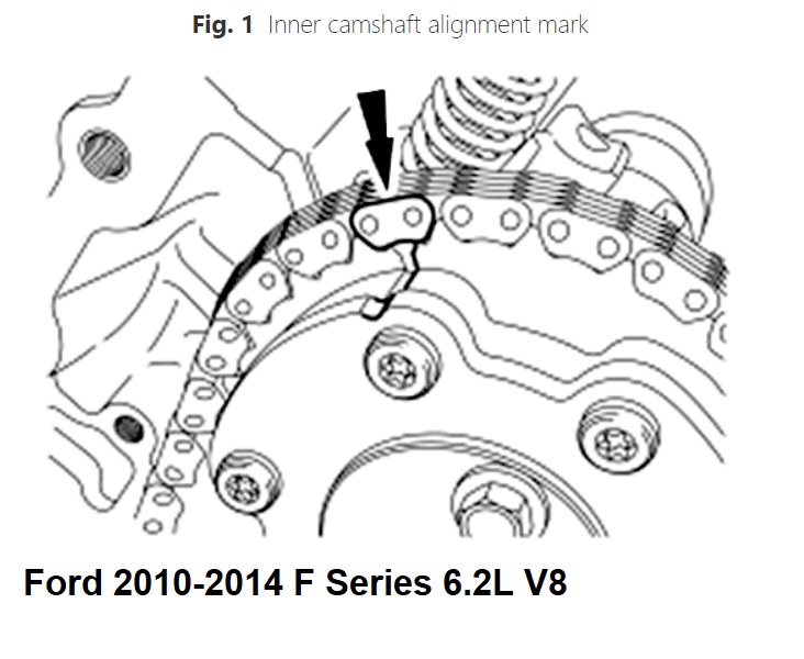

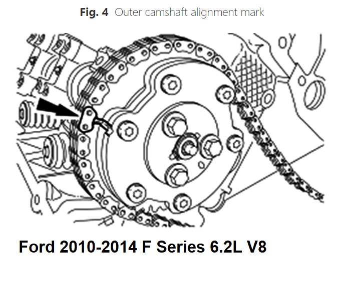

b.Position upper end of lefthand (inner) timing chain on lefthand camshaft phaser and sprocket, aligning timing mark on outer flange of camshaft phaser and sprocket with single blue marked link on chain, Fig. 1.

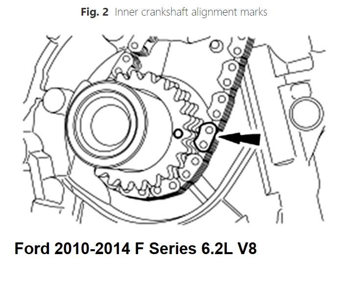

c.Position lower end of lefthand (inner) timing chain on crankshaft sprocket, aligning timing mark on outer flange of crankshaft sprocket with single blue marked link on chain and install crankshaft sprocket onto crankshaft, then verify crankshaft keyway is at 11 o'clock position, Fig. 2.

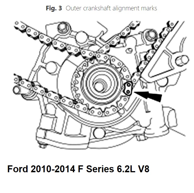

f.Position lower end of righthand (outer) timing chain on crankshaft sprocket, aligning timing mark on sprocket with single blue marked chain link, Fig. 3.
g.Position upper end of righthand (outer) timing chain on righthand camshaft phaser and sprocket, aligning timing mark on outer flange of camshaft phaser and sprocket with single blue marked link on chain, Fig. 4.

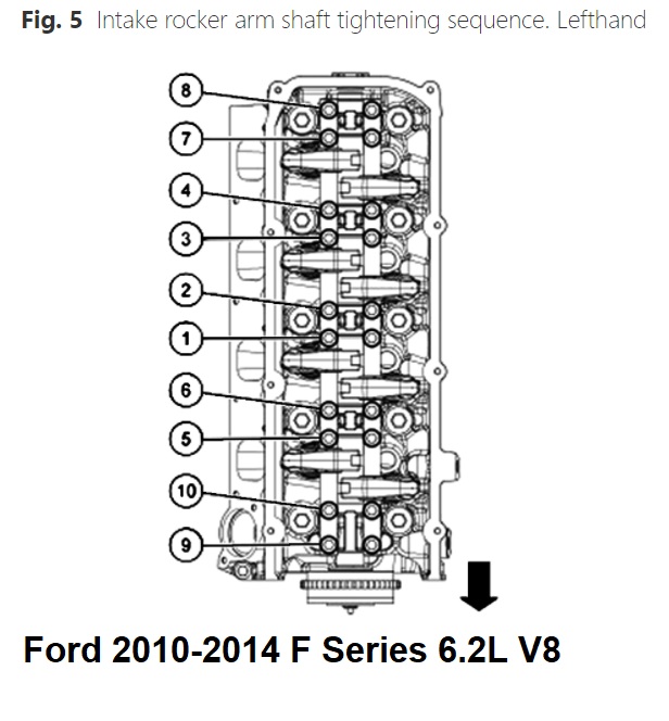

j.Tighten lefthand intake rocker arm shaft assembly bolts in sequence as illustrated in Fig. 5. First step, torque bolts to 89 inch lbs., second step, torque to 177 inch lbs., third step, tighten an additional 60°.

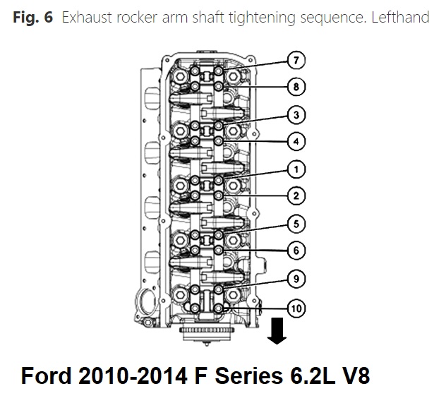

k.Tighten lefthand exhaust rocker arm shaft assembly bolts in sequence as illustrated in Fig. 6. First step, torque bolts to 89 inch lbs., second step, torque to 177 inch lbs., third step, tighten an additional 60°.

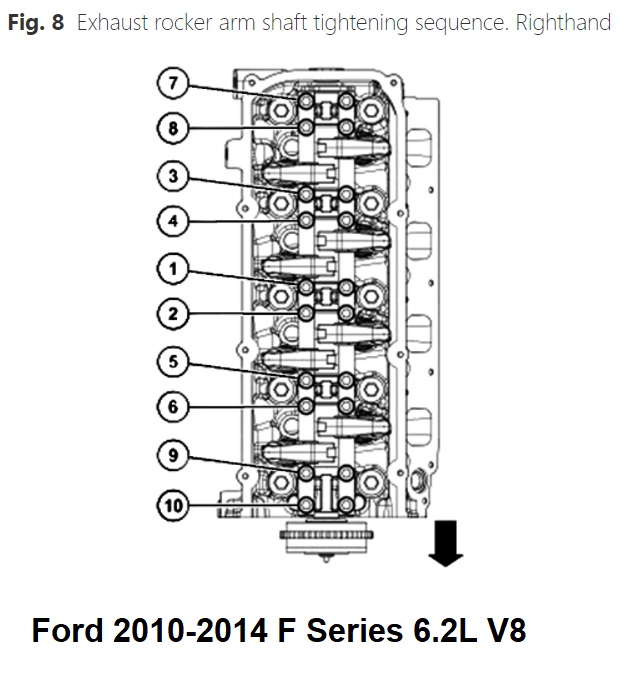

m.Tighten righthand exhaust rocker arm shaft assembly bolts in sequence as illustrated in Fig. 8. First step, torque bolts to 89 inch lbs., second step, torque to 177 inch lbs., third step, tighten an additional 60°.
