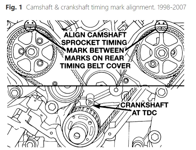

8.Rotate the crankshaft clockwise until the timing mark aligns with the TDC mark on the oil pump housing, and the camshaft sprocket timing marks are between marks on the rear timing belt covers, Fig. 1.
9.Mark the exact position of the camshaft sprocket timing marks relative to the two rear cover marks using an ink or paint marker.

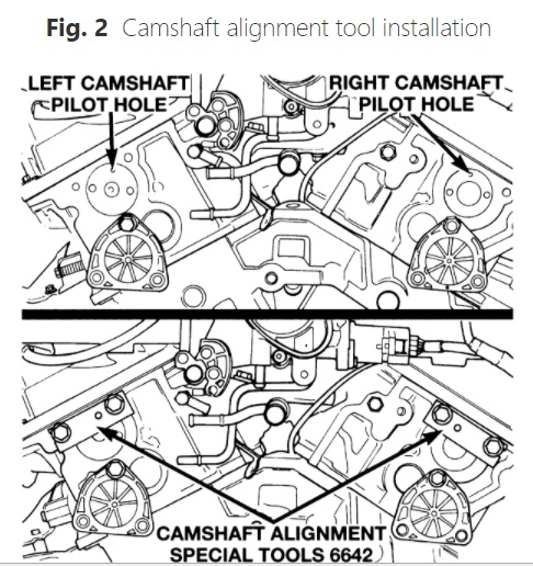

d.Remove the cam covers, then install the DaimlerChrysler camshaft alignment tool No. 6642, or equivalent, to the rear of each cylinder head, Fig. 2.
e.Install the camshaft sprockets onto the camshafts with new attaching bolts. The left camshaft sprocket can be identified by the pickup slots on the rear of the sprocket. The 255 mm bolt is used to retain the lefthand camshaft sprocket while the 213 mm bolt is used to retain the righthand camshaft sprocket. Do not tighten the camshaft sprocket retaining bolts.
f.The camshaft sprocket timing marks should be positioned between the timing marks on the cover, Fig. 1. Do not tighten the camshaft sprocket retaining bolts until after the timing belt and tensioner have been installed.

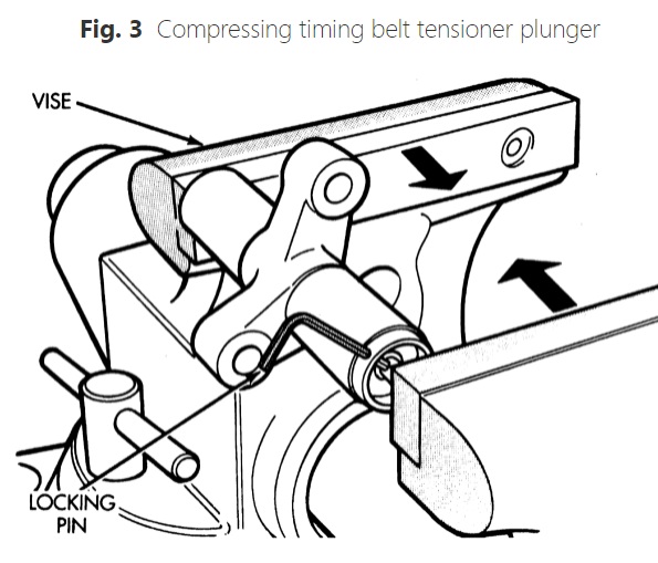

15.Position the timing belt tensioner in a soft-jawed vise, then slowly compress plunger into tensioner body, Fig. 3. Total tensioner bleed down should take approximately 5 minutes. Index the tensioner in the vise in the same way it is installed on the engine.
16.When the timing belt tensioner plunger is compressed into the tensioner body, install a suitable pin through the body and plunger to keep the plunger in place until installation, Fig. 3. If the tensioner will not be installed soon it should be stored in a vertical position with its plunger facing upward.

18.Each camshaft mark should still fall between the cover marks.
19.After the tensioner is securely in place, remove the retaining pin to allow the tensioner to expand to the pulley bracket.

a.With the No. 1 piston at TDC and camshaft sprocket timing marks aligned, hold camshaft sprocket in position with a 36 mm box wrench and tighten the sprocket retaining bolt. Torque the right camshaft sprocket bolt to 75 ft. lbs., then tighten the bolt an additional 90°. Torque the left camshaft sprocket bolt to 85 ft. lbs., then tighten the bolt an additional 90°.
b.Remove the dial indicator from the No. 1 cylinder and install spark plug.
c.Remove the camshaft alignment tools from the rear of the camshafts.

21.Rotate the crankshaft sprocket two revolutions and inspect all the timing marks, which should properly align within their respective locations, Fig. 1. If the marks do not align, repeat the procedure.
