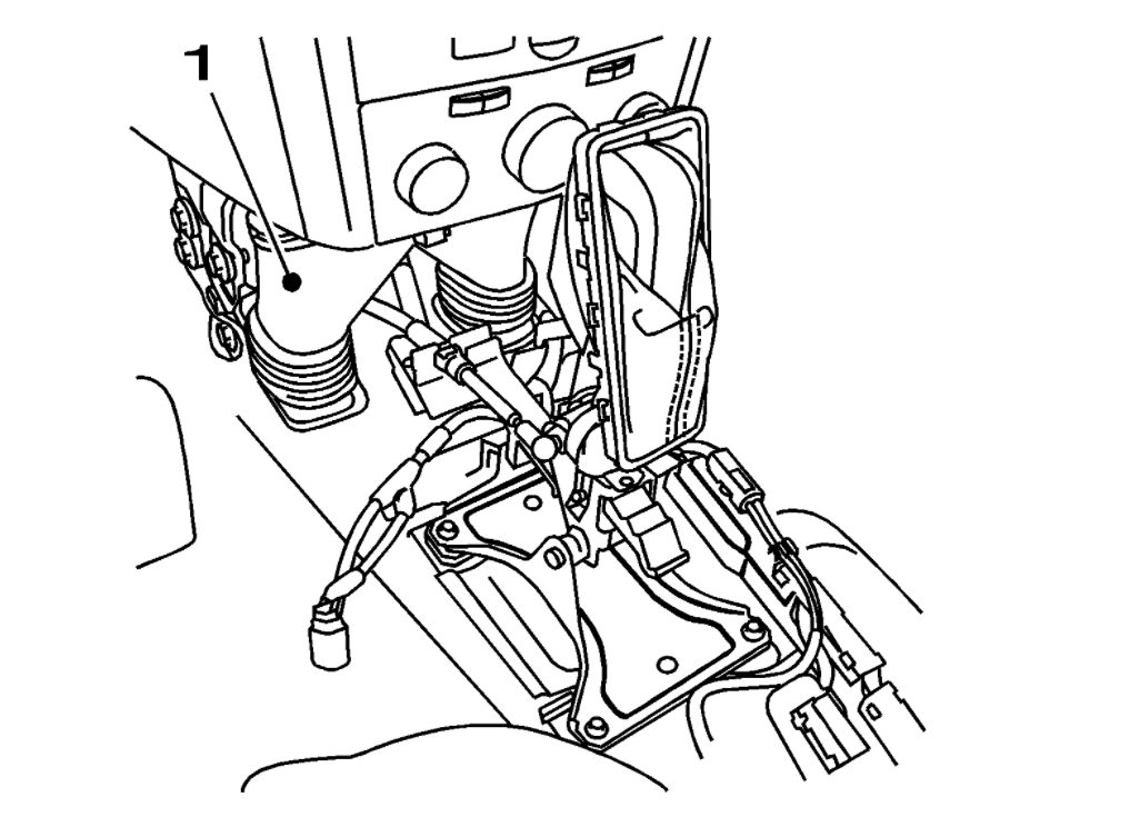

1. Remove the center console. Refer to Front Floor Console Replacement (See: Console > Removal and Replacement).
Imagen1
2. Remove the vent duct (1).
Important: Do not damage the wiring harness.
3. Open the cable ties (1).
4. Remove the cable ties (2) from the bracket.
5. Disconnect the wiring harness plug (3).
6. Detach the wiring harness plug (4) from the transmission control module (TCM).
Release the wiring harness plug and disconnect.

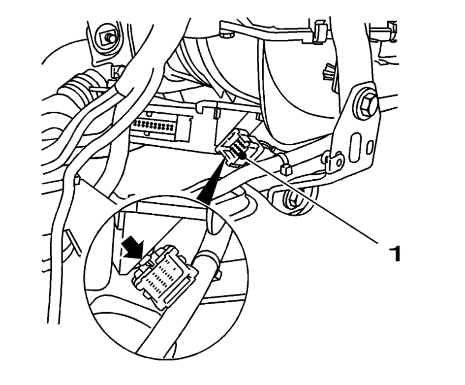

7. Remove the TCM with bracket.
* Slightly pull out the TCM with bracket.
* Detach the wiring harness plug (1) from the bracket.
Release the wiring harness plug (arrow).
* Remove the TCM with bracket.

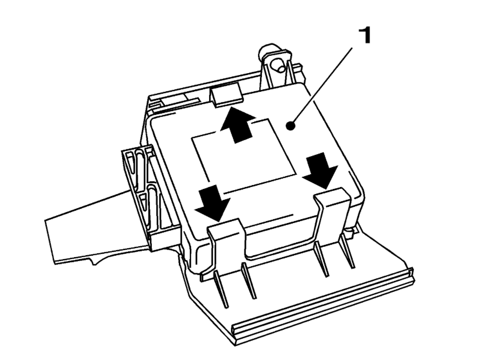

8. Detach the TCM (1) from the bracket.
Carefully push locks (arrows) outward.
