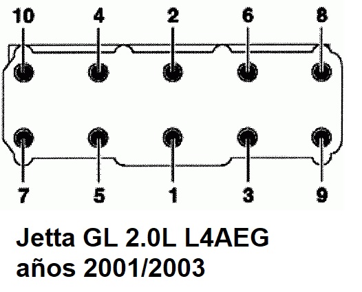

Torque de Cabeza Jetta GL 2.0L L4AEG años 2001/2003
Torque cylinder head bolts in sequence, using three steps, first to 30 ft. lbs., then turn 90° and finally an additional 90°.
