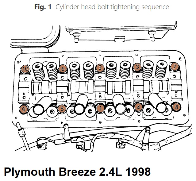

Para quien lo ocupe, torque de cabeza Plymouth Breeze 2.0L / 2.4L 1998
CYLINDER HEAD, REPLACE

14.Reverse procedure to install, noting the following:
a.Apply oil to bolts before installing.
b.Install four short bolts in positions 7, 8, 9 and 10, Fig. 1.
c.Using sequence shown in Fig. 1, tighten cylinder head bolts in four steps. First step, torque bolts to 25 ft. lbs.; second step, torque bolts to 50 ft. lbs.; third step, torque bolts to 50 ft. lbs.; fourth step, tighten bolts an additional 1/4 turn without using a torque wrench.
    148,6 KB · Visitas: 302
