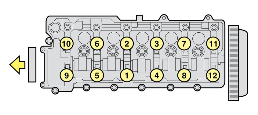

Cylinder head.
Renew Bolts then tighten as per the sequence below to 30Nm then 65Nm then Tighten 90° then Tighten 180° then Tighten 45°
