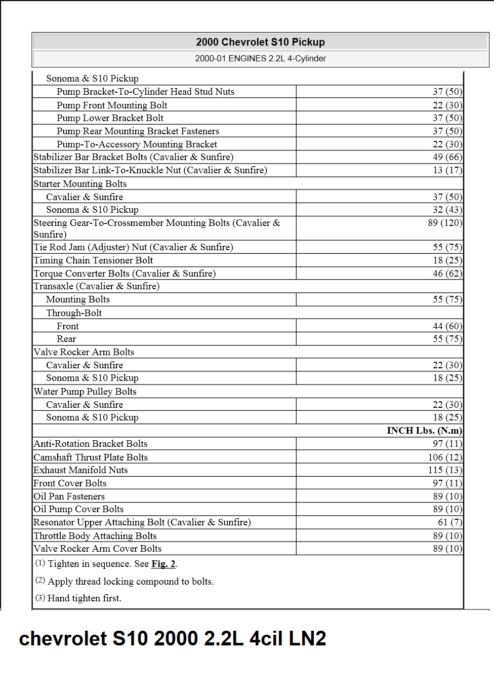

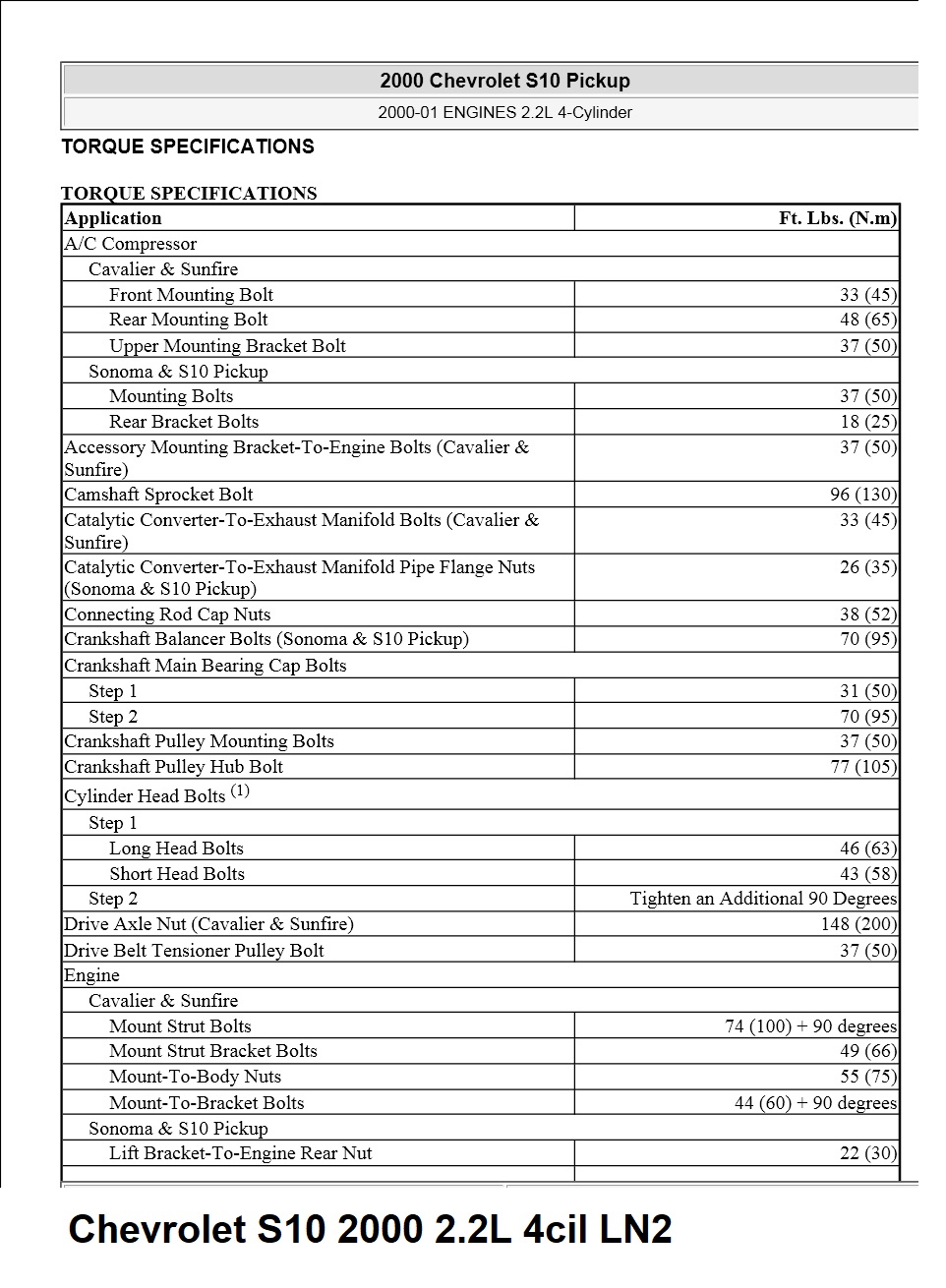

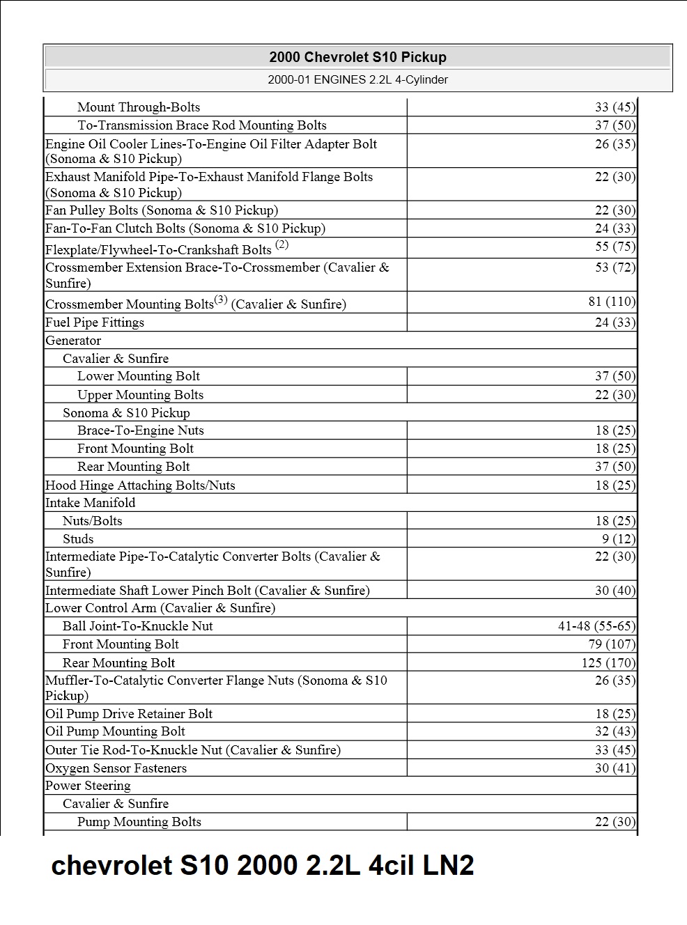

Hola amigos, les comparto la informacion tecnica de torques para chevrolet S10 2000 2.2L 4cil , sirve tambien para GMC Sonoma con motores LN2 y L42

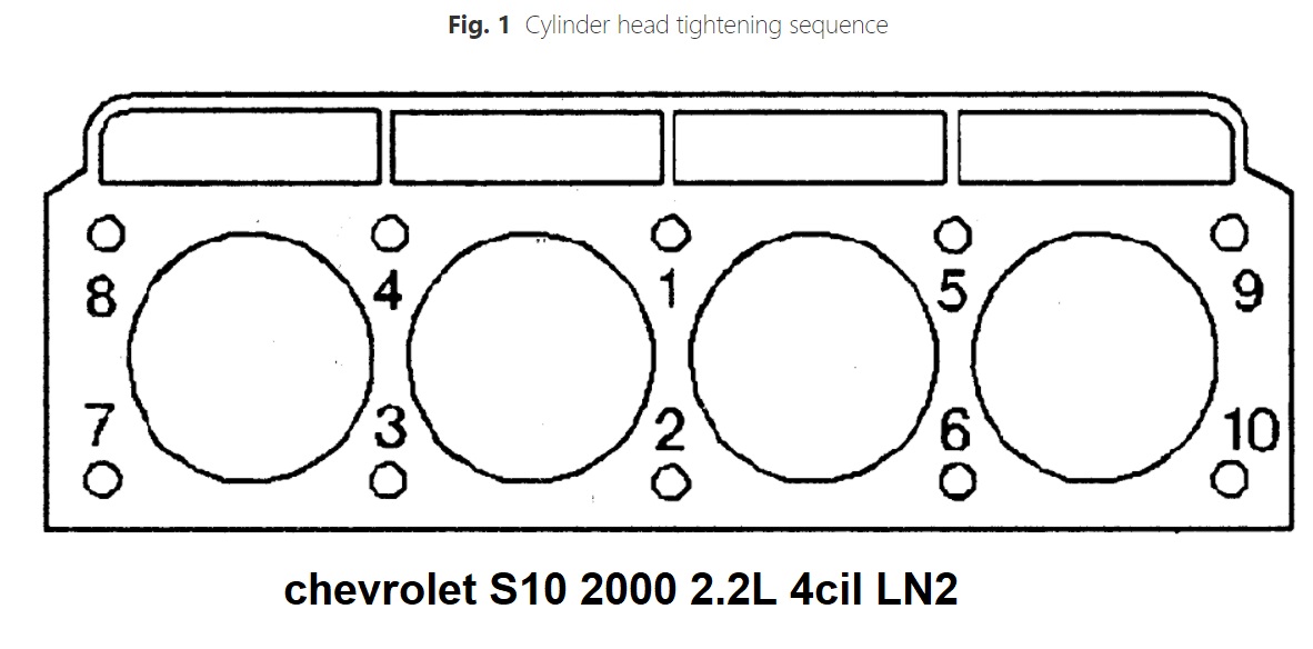

18.Disconnect engine lift bracket from rear of engine, then remove cylinder head bolts and studs. Remove cylinder head.
19.Reverse procedure to install, noting the following:
a.Using sequence shown in Fig. 1, tighten cylinder head bolts in two steps.
b.First step, torque long bolts to 46 ft. lbs. and the short bolts to 43 ft. lbs.
c.Second step, tighten all bolts an additional 90.°
