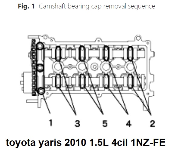

32.Using sequence, Fig. 1, uniformly loosen and remove 19 bearing cap bolts in several steps, then remove camshaft bearing caps from camshafts.

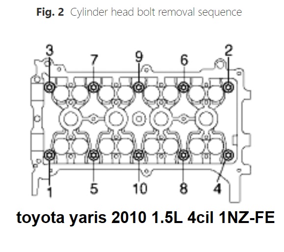

34.Using sequence, Fig. 2, uniformly loosen and remove 10 cylinder head bolts with an 8 mm bi-hexagon wrench in several steps. Remove 10 plate washers.

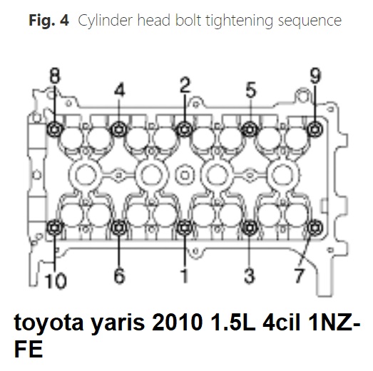

47.Reverse procedure to install, noting the following:

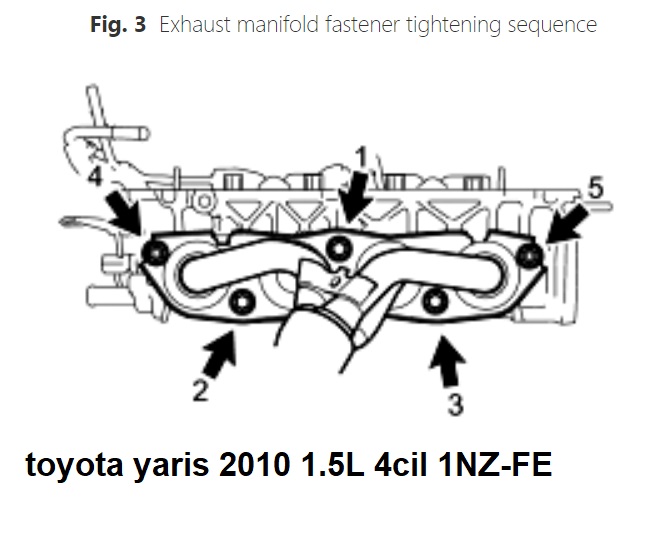

a.Using sequence, Fig. 3, torque exhaust manifold bolts and nuts in several steps to 20 ft. lbs.
b.Apply light coat of engine oil to cylinder head bolt threads.
c.Using sequence, Fig. 4, uniformly tighten 10 cylinder head bolts and plate washers in several steps. First step, torque bolts to 22 ft. lbs; second step, tighten bolts an 90°; third step, tighten bolts an additional 90°.

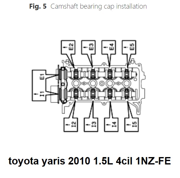

d.Install bearing caps in order shown in Fig. 5, and provisionally tighten 19 bolts.

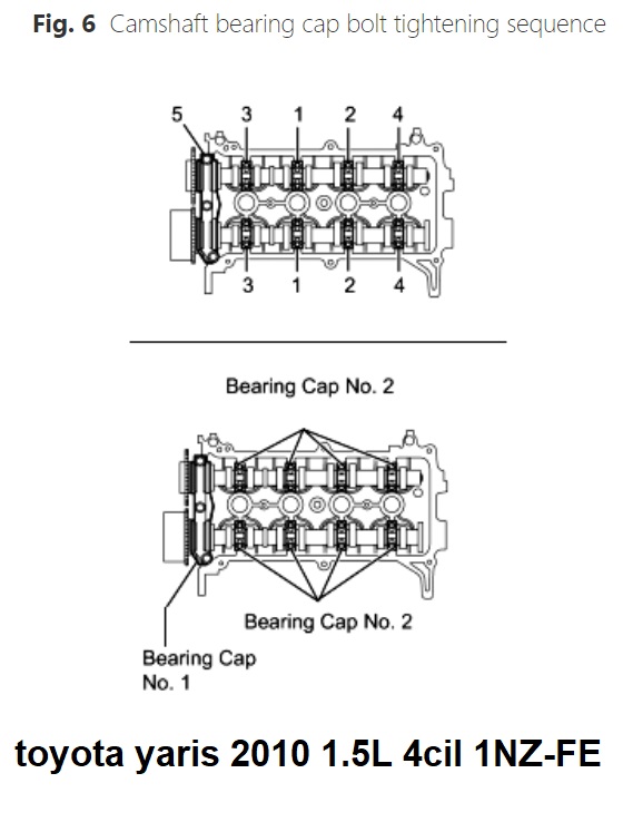

e.Using sequence, Fig. 6, uniformly tighten camshaft bearing cap bolts in several steps. Torque camshaft bearing cap No. 1 bolts to 17 ft. lbs. Torque camshaft bearing cap No. 2 bolts to 108 inch lbs.
