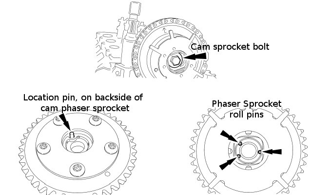

Use a two step torque sequence, on the Camshaft Phaser Sprocket Bolt
1. tighten to 30 lb-ft
2. tighten an additional 90 degrees
Replaces Ford part #: 3R2Z-6A257-DA
    45,4 KB · Visitas: 1.299
