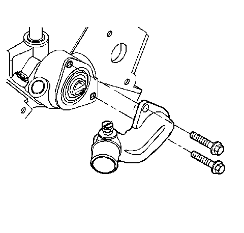

imagen 1
1. Remove the thermostat housing.

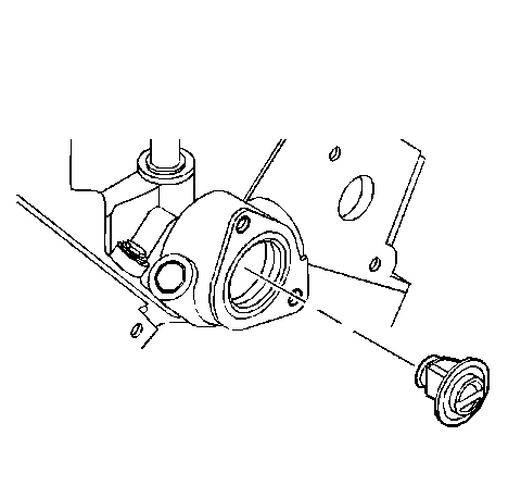

imagen 2
2. Remove the thermostat.
3. Clean and inspect the thermostat housing gasket mating surfaces.
