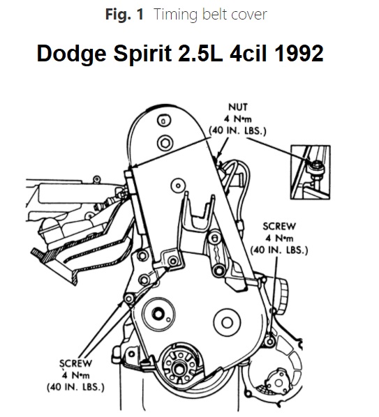

5.Remove the nuts securing the timing belt cover to the cylinder head and the cylinder block, then the timing belt cover halves, Fig. 1.

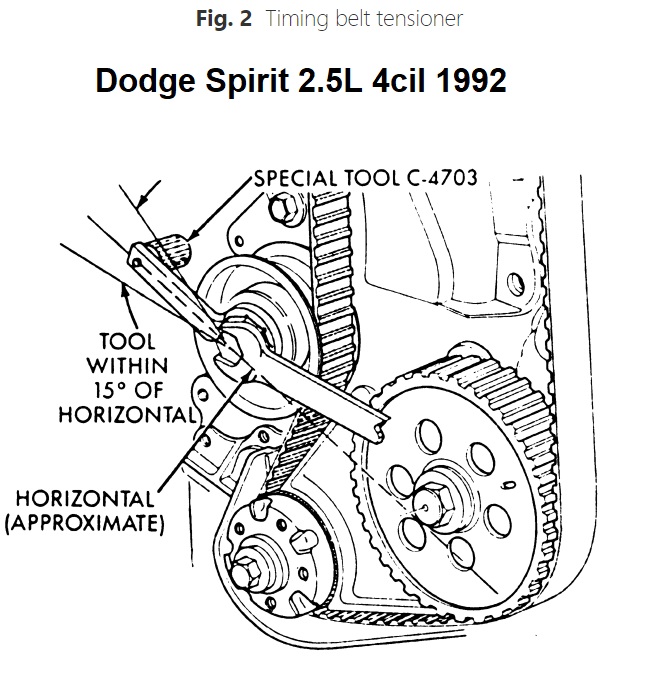

7.Loosen the timing belt tensioner, then remove the timing belt, Fig. 2.

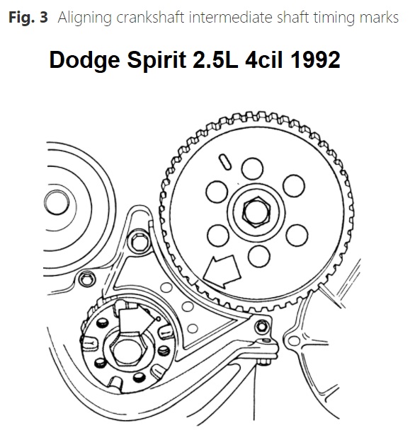

8.Rotate the crankshaft and the intermediate shaft until markings on the sprockets are aligned as illustrated in, Fig. 3.

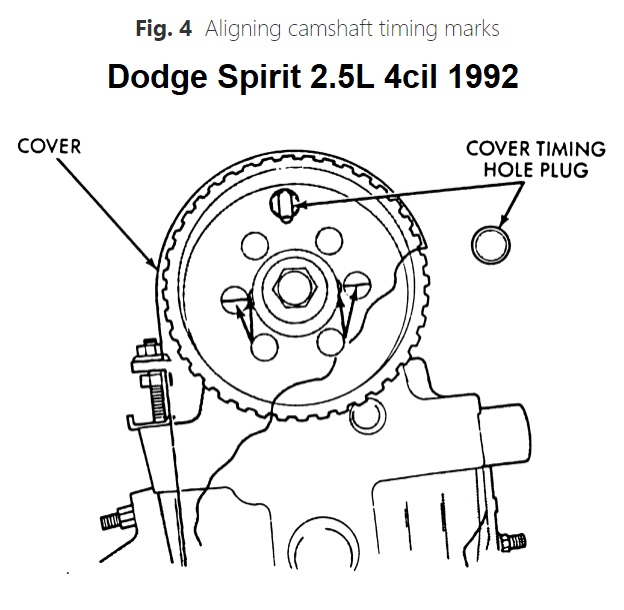

9.Rotate the camshaft until the arrows on the hub are aligned with the No. 1 camshaft cap to cylinder head line, Fig. 4. The small hole must be located along vertical center line.
10.Ensure that all timing marks are still aligned.
11.Install the timing belt. Inspect all alignment marks.
12.Set the belt tension so that the DaimlerChrysler belt tension tool C-4703 axis is within 15° of horizontal, Fig. 2.
13.Rotate the crankshaft two revolutions clockwise, then position at TDC. Tighten the tensioner locknut.

15.Install the timing belt cover halves.
