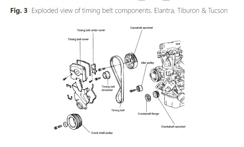

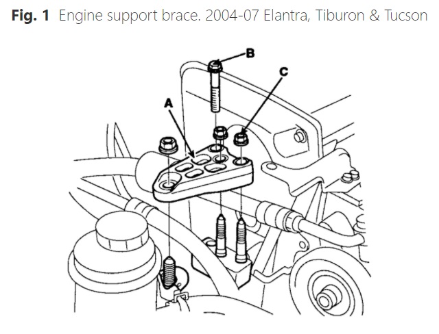

Hola si, sirve para Tucson, dejo el manual: Cambio de Banda de tiempo para Elantra, Tiburon y Tucson 2.0L años 2004/2007

8. Remove the engine mounting brace attaching bolts and nuts, then the brace, Fig. 1.

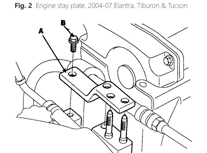

9. Remove the engine stay plate retaining bolts, then the stay plate, Fig. 2.

13. Remove the upper timing belt front cover retaining bolts, then the upper cover, Fig. 3.

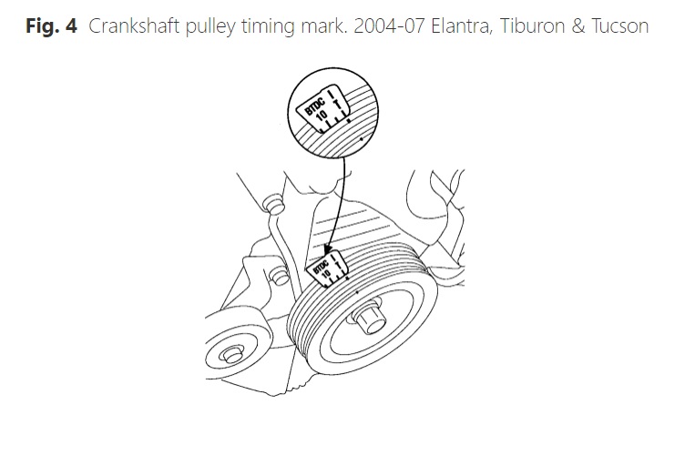

14. Rotate the crankshaft pulley in the clockwise direction until the pulley mark is aligned with the T mark on the timing tab, Fig. 4.
15. Remove the crankshaft pulley mounting bolt, then the pulley and flange plate.
16. Remove the lower timing belt front cover, Fig. 3.

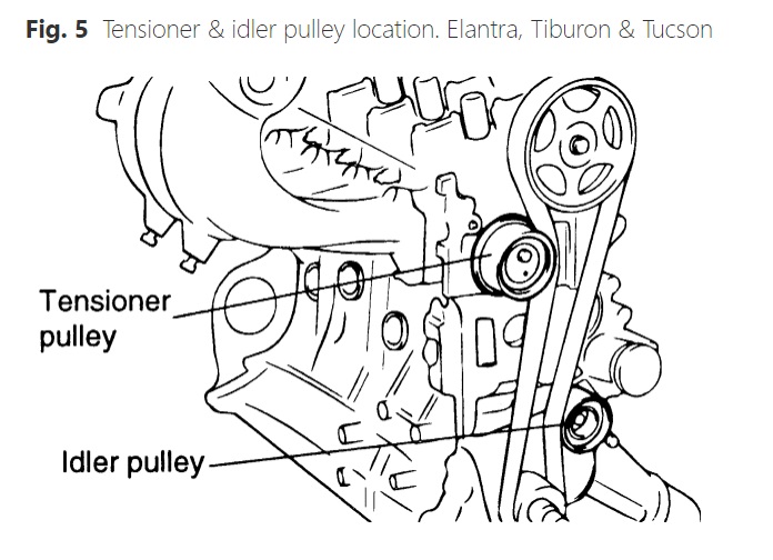

17. Remove the timing belt tensioner pulley, Fig. 5.

19. Inspect the timing belt tensioner and idler pulleys as follows:
a. Inspect the timing belt tensioner and idler pulley for smooth rotation, play and noise and replace as required.
b. Inspect the tensioner and idler pulleys for abnormal wear, cracks and other damage and replace as required.
c. Replace pulley if grease is leaking from the bearing.

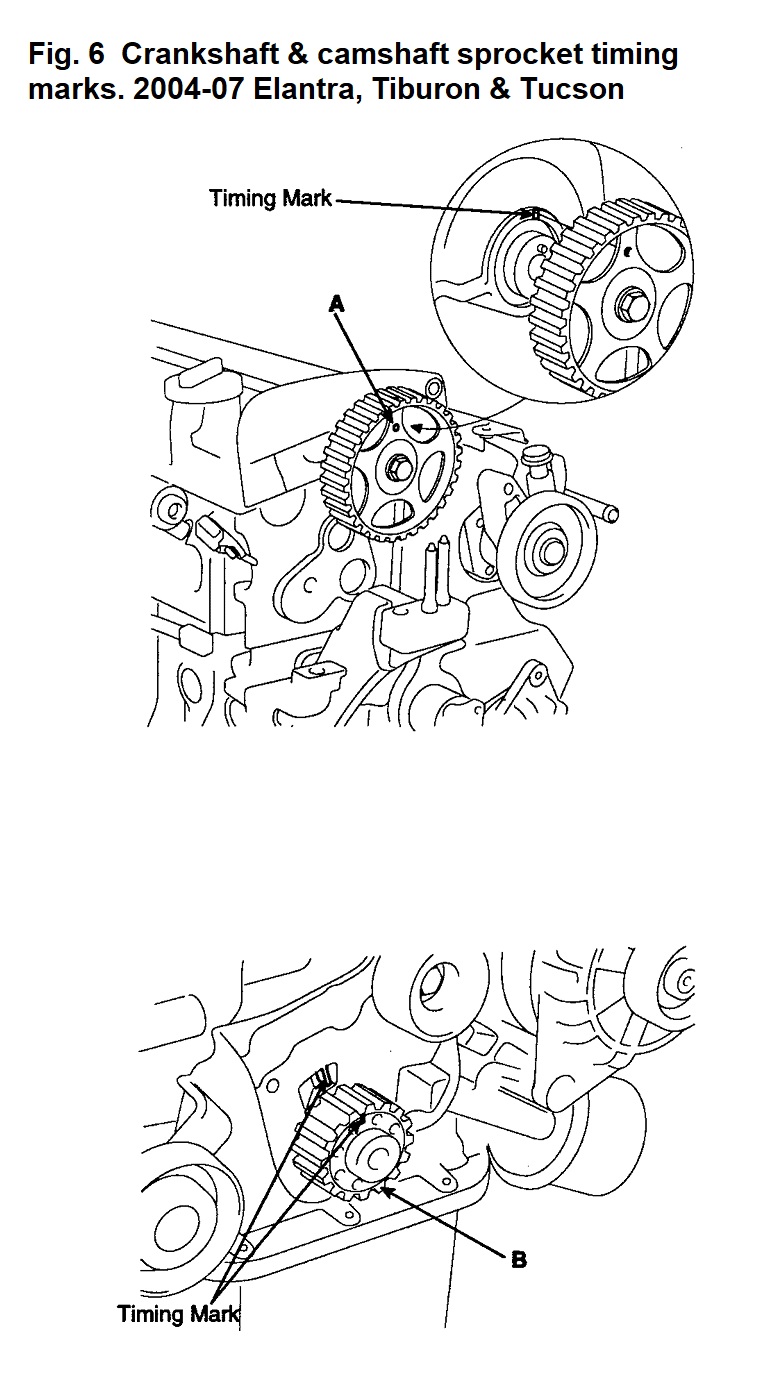

20. Align the timing marks of the crankshaft sprocket and camshaft sprocket with the No. 1 piston placed at TDC compression stroke, Fig. 6.

24. Rotate the crankshaft slightly in the clockwise direction until the camshaft has moved two teeth.

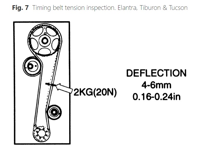

27. Check the timing belt tension by applying a force of 5 lbs. to the timing belt between camshaft sprocket and the idler pulley and measuring the belt deflection, Fig. 7. The timing belt deflection should be between .16 to .24 inch.
28. Turn the crankshaft two turns in a clockwise direction and realign crankshaft sprocket timing mark, Fig. 6.Do not turn crankshaft in a counterclockwise direction.
29. Install the lower timing belt front cover and torque bolts to 6-7 ft. lbs.

34. Install the engine stay. Tighten the retaining bolt to 32 to 40 ft. lbs.
