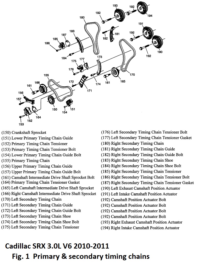

3.Remove righthand side secondary camshaft drive chain tensioner attaching bolts, then the drive chain tensioner, Fig. 1.
4.Remove righthand side secondary timing chain shoe, then the righthand side secondary drive chain.

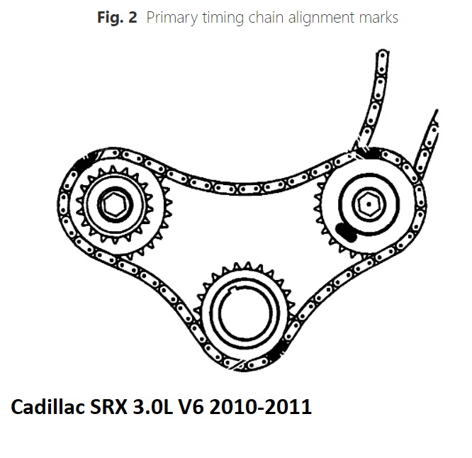

2.Wrap primary camshaft drive chain around large sprockets of each camshaft intermediate chain idler and crankshaft sprocket.
3.Align lefthand side camshaft intermediate drive chain idler timing mark with bright plated camshaft drive chain link, Fig. 2.
4.Align righthand side camshaft intermediate drive chain idler timing mark with bright plated camshaft drive chain link, Fig. 2.
5.Align crankshaft sprocket timing mark with bright plated camshaft drive chain link, Fig. 2.

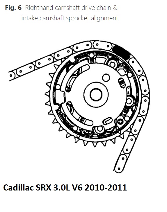

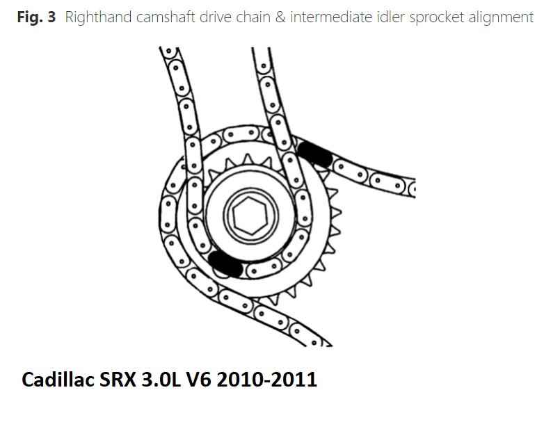

13.Place righthand side secondary camshaft drive chain around righthand side camshaft intermediate drive chain idler outer sprocket, align bright plated camshaft drive link with alignment access hole in camshaft drive chain idler inner sprocket, Fig. 3.

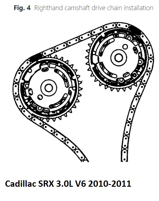

14.Wrap secondary camshaft drive chain around both righthand side actuator drive sprockets, ensuring there are seven darkened links between bright plated camshaft drive chain links for camshaft position actuator sprockets, Fig. 4.

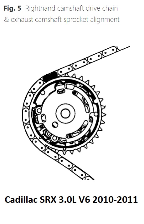

15.Align righthand side exhaust camshaft position actuator sprocket alignment triangle mark with bright plated camshaft drive chain link, Fig. 5.
16.Align righthand side intake camshaft position actuator sprocket alignment triangle mark with bright plated camshaft drive chain link, Fig. 6.

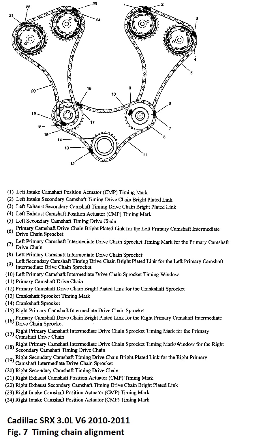

25.Ensure all timing marks are aligned, Fig. 7.

2.Place righthand side secondary camshaft drive chain around righthand side camshaft intermediate drive chain idler outer sprocket, align bright plated camshaft drive link with alignment access hole in camshaft drive chain idler inner sprocket, Fig. 3.
3.Wrap secondary camshaft drive chain around both righthand side actuator drive sprockets, ensuring there are seven darkened links between bright plated camshaft drive chain links for camshaft position actuator sprockets, Fig. 4.
4.Align righthand side exhaust camshaft position actuator sprocket alignment triangle mark with bright plated camshaft drive chain link, Fig. 5.
5.Align righthand side intake camshaft position actuator sprocket alignment triangle mark with bright plated camshaft drive chain link, Fig. 6.

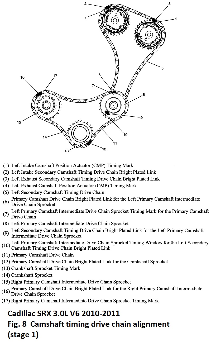

2.Ensure crankshaft is in "Stage 1" timing drive assembly position, Fig. 8.

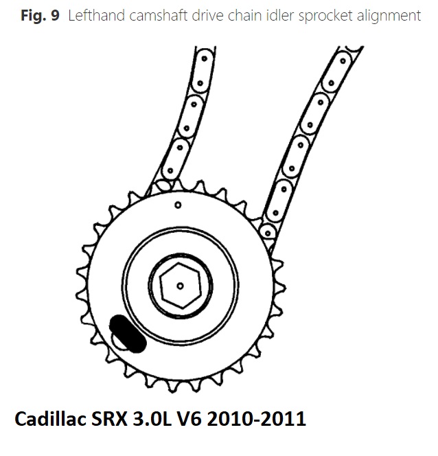

3.Place lefthand side secondary camshaft drive chain around inner sprocket of camshaft intermediate drive chain idler with bright plated drive chain link aligned to access hole in idler outer sprocket, Fig. 9.

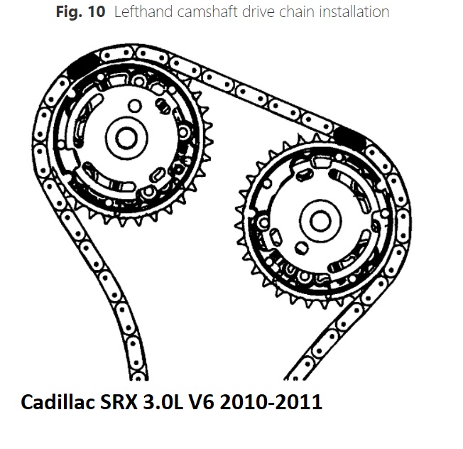

5.Ensure there are seven darkened links between bright plated camshaft drive chain links for camshaft position actuator sprockets, Fig. 10.

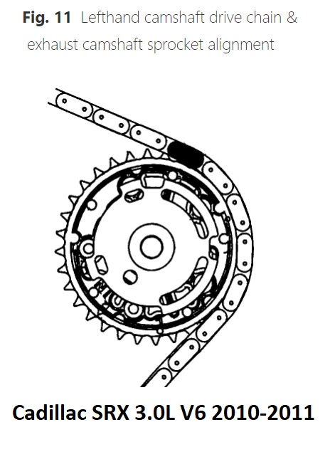

6.Align lefthand side exhaust camshaft position actuator sprocket alignment circle mark with bright plated camshaft drive chain link, Fig. 11.

17.Ensure all timing marks are aligned, Fig. 7.
