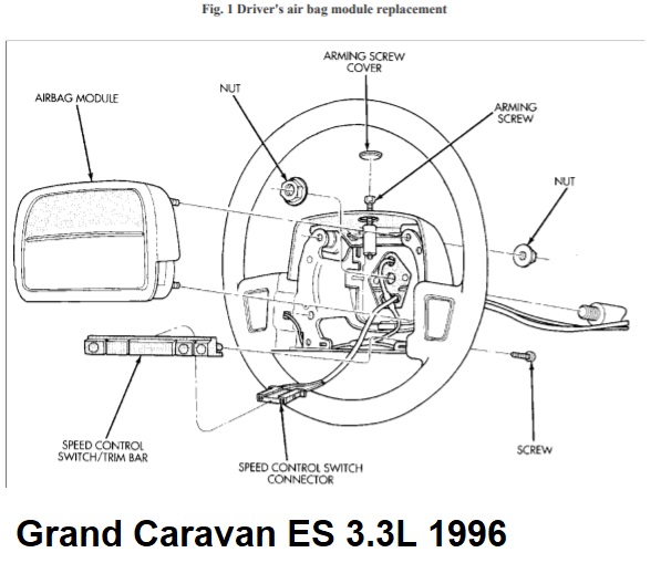

DRIVER'S SIDE AIR BAG MODULE, REPLACE
Use extreme caution to prevent any foreign material from entering driver's air bag module, or becoming trapped between trim cover and module. Failure to observe this warning could result in occupant injuries upon air bag deployment.
1.Disarm air bag system air bag system as outlined under "Air Bag System Disarming & Arming."
2.Remove driver's air bag module nuts to steering wheel, Fig. 1.
3.Lift air bag module and disconnect electrical connector.
4.Remove driver's air bag module.
5.Reverse procedure to install, noting the following. Arm air bag system as outlined under "Air Bag System Disarming & Arming."
6.Torque driver air bag module to 80-100 inch lbs.

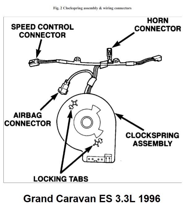

Centering
The clockspring may fail during use if its rotating portion is not properly positioned with the steering column and front wheels. The following procedure must be used if the clockspring is not known to be properly positioned:
1.Place front wheels in straight-ahead position.
2.Move locking pins or tabs as needed to disengage locking mechanism, Fig. 2.
3.From end of travel, rotate clockspring rotor three turns counterclockwise. All wires should end up on top.
4.Release locking fingers or pins to engage clockspring mechanism.

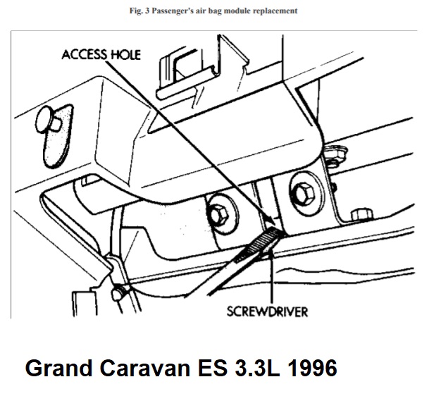

Grand Caravan ES 3.3L 1996
PASSENGER'S SIDE AIR BAG MODULE, REPLACE
Use extreme care to prevent any foreign material from entering the passenger side air bag module, or becoming entrapped between the instrument panel top cover and the passenger side air bag module. Failure to observe this warning could result in occupant injuries upon air bag deployment.
Non-Deployed
1.Disarm air bag system as outlined under "Air Bag System Disarming & Arming."
2.Disconnect glove compartment door and allow door to fully open.
3.Remove passenger's air bag module mounting screws.
4.Pry passenger's air bag module up with large flat tipped screwdriver to unsnap door from trim pad, then lift away from snaps, Fig. 3.
5.Holding on to door, lift passenger's air bag module from opening and rest air bag module on trim pad.
6.Disconnect electrical connectors and remove passenger's air bag module.
7.Reverse procedure to install, noting the following. Arm air bag system as outlined under "Air Bag System Disarming & Arming."
8.Torque passenger air bag module to 50 inch lbs.

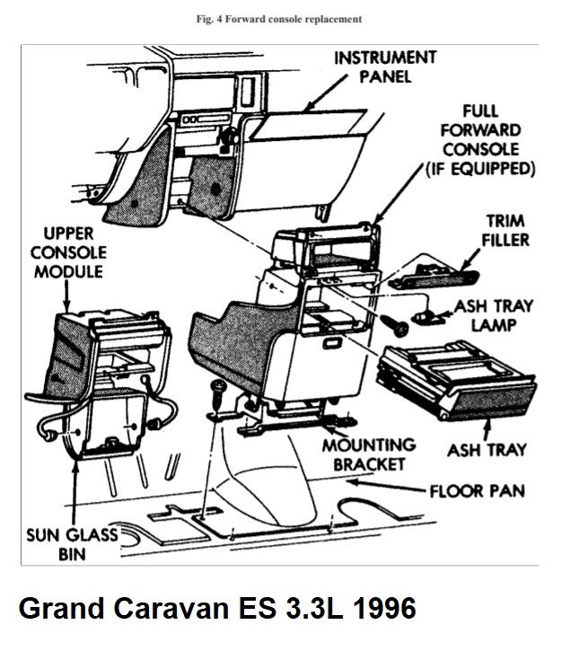

AIR BAG SYSTEM DIAGNOSTIC MODULE (ASDM), REPLACE
2.Remove forward console, Fig. 4.
3.Remove module and bracket attaching screws.
4.Carefully lift module up and rearward, disconnect electrical connectors, then remove module.
5.Reverse procedure to install, noting the following:
a.Position module and bracket facing forward.
b.Arm air bag system as outlined under "Air Bag System Disarming & Arming."
