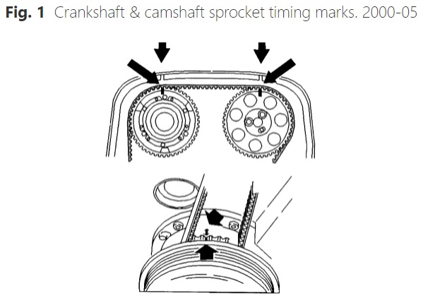

13.Turn the crankshaft clockwise until the crankshaft and camshaft timing marks are aligned, Fig. 1.
14.Rotate the crankshaft an additional 1/4 turn clockwise.
15.Turn the crankshaft back counterclockwise until crankshaft and camshaft sprocket timing marks align, Fig. 1.

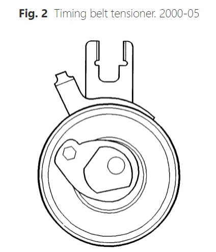

19.Loosen the timing belt tensioner center screw slightly.
20.While holding the tensioner center screw, turn the tensioner eccentric counterclockwise with a 6 mm hex wrench to the 10 o'clock position, Fig. 2.

22.Ensure the crankshaft sprocket and camshaft sprocket timing marks are properly aligned, Fig. 1.

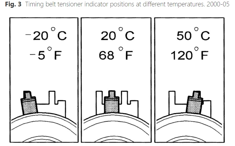

25.While holding the timing belt tensioner center screw in position, rotate the tensioner eccentric clockwise with a 6 mm hex wrench until the tension indicator passes the marked position, Fig. 3.
26.Turn the timing belt tensioner eccentric back so that the tension indicator reaches the marked position in the center of the window.
27.While holding the timing belt tensioner eccentric in position, torque the tensioner center screw to 15 ft. lbs.
28.Ensure the tensioner indicator is in the correct position, Fig. 3.

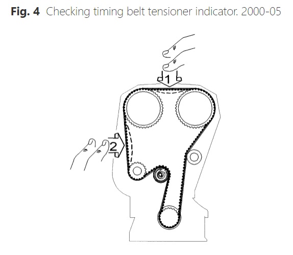

29.Press on the timing belt, Fig. 4, and inspect that indicator on the timing belt tensioner moves easily.

32.Ensure the tensioner indicator is in the correct position, Fig. 3.
