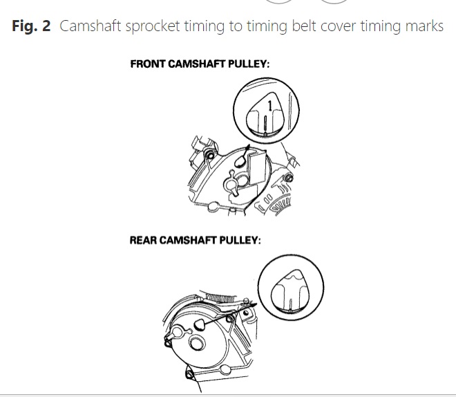

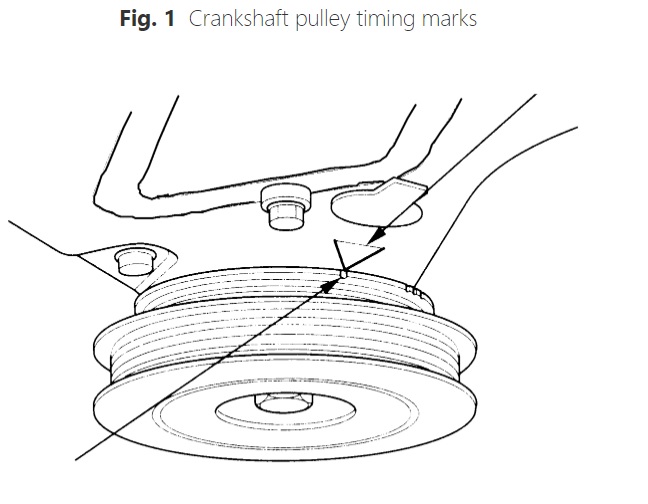

2.Rotate the crankshaft pulley clockwise until its white mark, Fig. 1, aligns with the pointer.
3.Ensure the rear camshaft sprocket mark, Fig. 2 aligns with the rear upper cover mark.

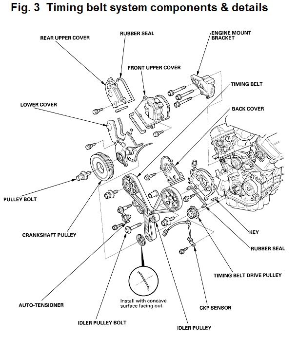

14.Remove the timing belt front upper cover, Fig. 3, rear upper and lower covers. Also note the timing belt lower guide plate orientation for proper installation.

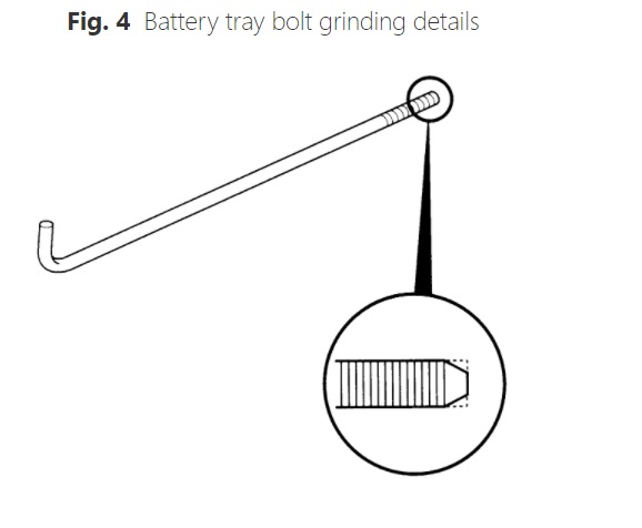

15.Remove a battery tray hold down bolt and grind the threaded end as illustrated, Fig. 4.

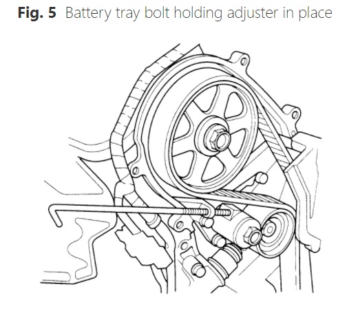

16.Thread the battery clamp bolt in as illustrated, Fig. 5, to retain the timing belt adjuster in its current position. Tighten by hand only. Do not use a wrench.

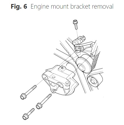

17.Remove the engine mount bracket, Fig. 6.

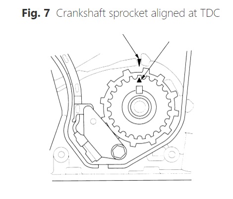

21.Set the crankshaft sprocket at TDC by aligning the TDC mark, Fig. 7, with the oil pump pointer.

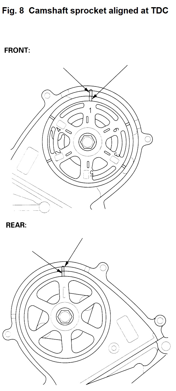

22.Set the camshaft sprockets at TDC by aligning the TDC marks, Fig. 8, with the pointers on the rear covers.

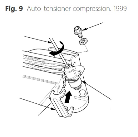

25.On 1999 models, proceed as follows:
a.Hold the tensioner, Fig. 9, with the maintenance bolt facing upward. Use caution when handling the tensioner to prevent oil leaks and spills. Refill oil as required. Total capacity is .22 fluid ounces.
b.Remove the maintenance bolt from the tensioner.
c.Clamp the tensioner boss in a suitable soft-jawed vise. Do not grip the tensioner housing.
d.Insert a flat blade screwdriver, Fig. 9, into the maintenance hole.
e.Place Honda stopper 14540-P8A-A01, or equivalent, on the tensioner while turning the screwdriver clockwise to compress the bottom. Avoid damaging the threads or the gasket contact surface.
f.Install the maintenance bolt with a new gasket.
g.After inspecting and correcting any oil leaks at the maintenance bolt, install the tensioner. Torque the bolts to 8.7 ft. lbs. Ensure the stopper tool stays in position.

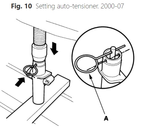

b.Slowly compress the auto-tensioner and insert an .08 inch diameter pin through the housing into the rod, Fig. 10. Do not exceed 2200 lbs. of pressure.

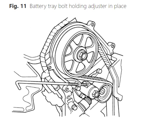

27.Thread the battery clamp bolt in as illustrated, Fig. 11, to retain the timing belt adjuster in its current position. Tighten by hand only. Do not use a wrench.

39.On all models, rotate the crankshaft pulley clockwise approximately 5 or 6 turns to position the timing belt on the sprockets, then align the white mark on crankshaft pulley, Fig. 1, with the pointer.
40.Inspect the camshaft sprocket marks, which should be at TDC, Fig. 2. If timing marks are improperly aligned, the timing belt must be removed and installed again.
