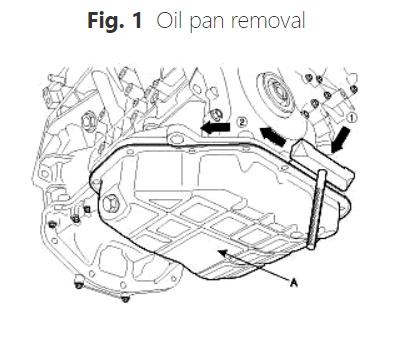

13.Insert blade of oil pan remover tool No. 09215-3C000, or equivalent, between upper oil pan and lower oil pan, and cut off applied sealer and remove lower oil pan, Fig. 1.

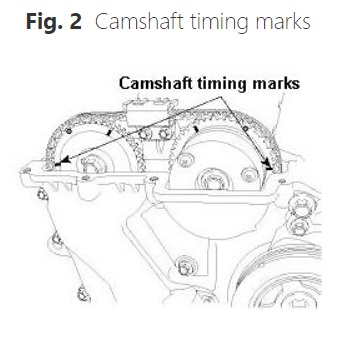

40.Set No. 1 cylinder to TDC/compression by turning crankshaft pulley and align its groove with timing mark "T" of lower timing chain cover. Do not rotate engine counterclockwise.
41.Ensure mark of camshaft timing sprockets are in straight line on cylinder head surface. If not, turn crankshaft one revolution (360°), Fig. 2.

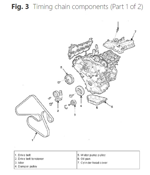

42.Remove drive belt, Fig. 3.

48.Remove drive belt idler and drive belt auto tensioner.

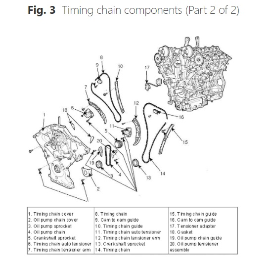

49.Remove water pump pulley and timing chain cover.
50.Install a set pin after compressing righthand timing chain tensioner.
51.Remove righthand cam to cam guide.
52.Remove righthand timing chain auto tensioner and righthand timing chain tensioner arm.
53.Remove righthand timing chain.
54.Remove righthand timing chain guide.
55.Remove oil pump chain cover.
56.Remove oil pump chain tensioner assembly.
57.Remove oil pump chain guide.
58.Remove oil pump chain sprocket and oil pump chain.
59.Remove crankshaft sprocket.
60.Install a set pin after compressing lefthand timing chain tensioner.
61.Remove lefthand cam to cam guide.
62.Remove lefthand timing chain auto tensioner and lefthand timing chain tensioner arm.
63.Remove lefthand timing chain.
64.Reverse procedure to install.

TIMING CHAIN, REPLACE - Hyundai Sonata 3.3L V6 2006 a 2010 - motor G6DB
