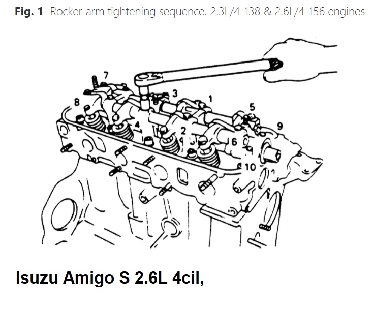

2.Check rocker arm shaft bracket nuts for looseness. Torque any loose rocker arm shaft brackets 1 through 8 to 16 ft. lbs., then brackets 9 and 10 to 6 ft. lbs., in sequence shown in Fig. 1.

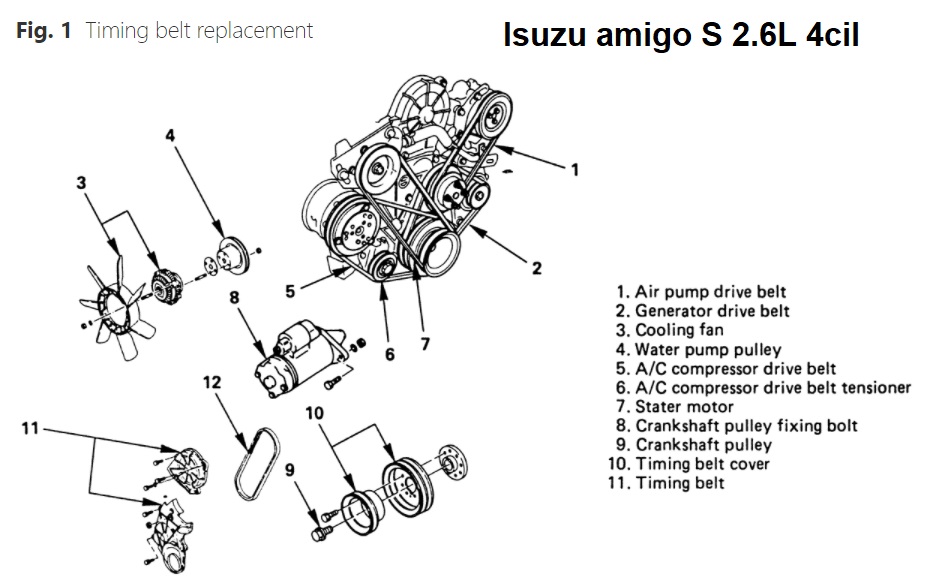

4.Remove the engine cooling fan, Fig. 1.

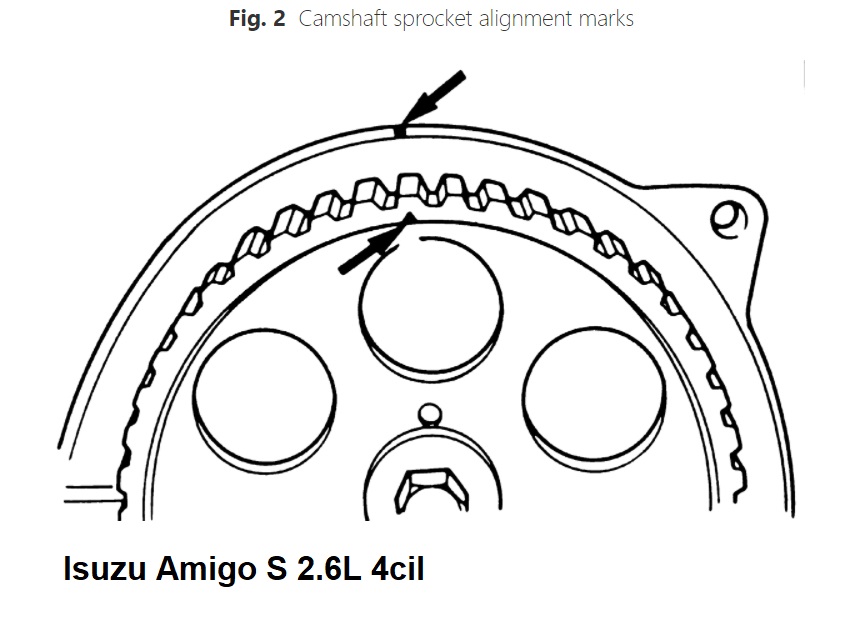

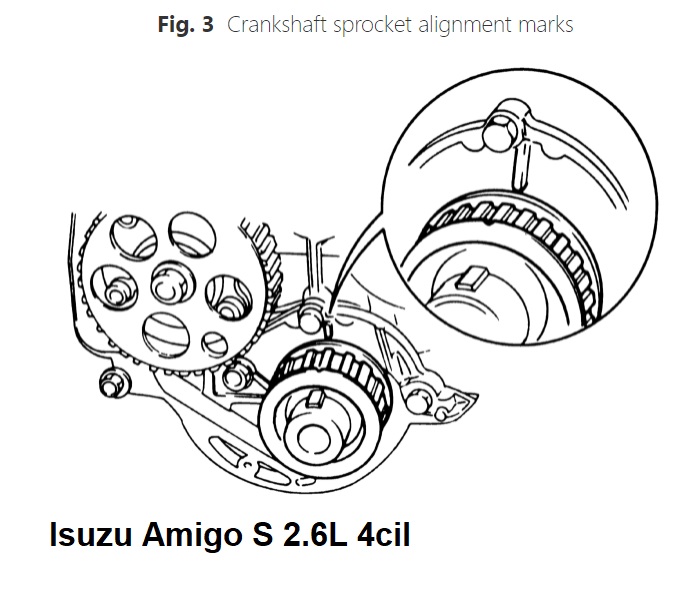

12.Ensure the camshaft and crankshaft sprocket marks are aligned, Figs. 2 and 3.

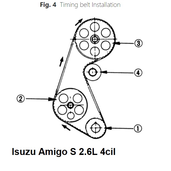

13.Install the timing belt on the crankshaft sprocket (1), the oil pump sprocket (2), camshaft sprocket (3) and the tensioner pulley (4), Fig. 4.

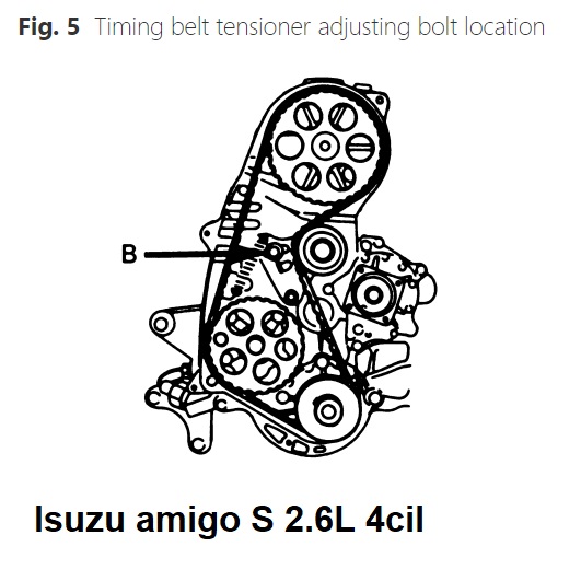

15.Tighten the tensioner retaining bolt, then rotate the crankshaft two turns counterclockwise. Ensure the crankshaft and camshaft marks are aligned, Figs. 2 and 3. If the sprocket marks are not aligned, remove and install the timing belt once again.
16.Loosen the timing belt tensioner adjusting bolt and allow the belt to tension, Fig. 5. After the belt has tensioned, tighten the tensioner bolts.
